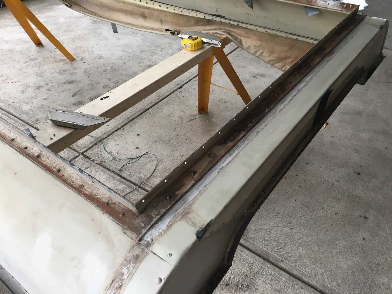

While I'm waiting for mine to get transported down from Qld I have started on the refurb of my mates roof - and I'm sure I'm going to have a few questions to ask along the way :whistle:
Here are a few picks of the '67 roof
And stripped down
1969 Series 2A Carawagon

Now for my first question:
When restoring these do you normally take off the aluminium angle that goes around the perimeter of the room opening to re-seal it?
Re: 2x Carawagon roof rebuids
Post by RMS » Sun Dec 09, 2018 10:51 am
JohnnoP wrote:Now for my first question:
I haven't found I've needed to on any of the ones I've done.
I think whatever sealant Searle used seems to have stood the test of time.
Hope that helps,

RMS wrote: I haven't found I've needed to on any of the ones I've done.
Hope that helps,
Fantastic - that saves me a heap of time!
I've notice the bottom edge of the ply sides have a bevel along its edge.
Did the top edge have the same bevel? Its hard to tell as the top edge has deteriorated so much. It almost seems that it might have had a rounded edge to the top of the ply.
Post by RMS » Sun Dec 09, 2018 1:41 pm
Yes, original sides (I assume some of the ones I've done had been original) had a bevel on the top edge, I assume it's so the seal isn't bent out at a right angle when the roof is up.

Post by JohnnoP » Mon Dec 10, 2018 1:07 am
Yes I imagine that would be the reason and also to allow water to drain away from the hinge.

Unfortunately not much progress on the roofs.
My mates one had a few cracks in the aluminium which have been welded up and now needs to paint the roof which wasn’t part of the plan.
We have the marine ply, stainless steel hinges and screws but still need to get the rubber seals.
In the mean time I’ve been stripping mine down to do the rust repairs on the bulkhead.
