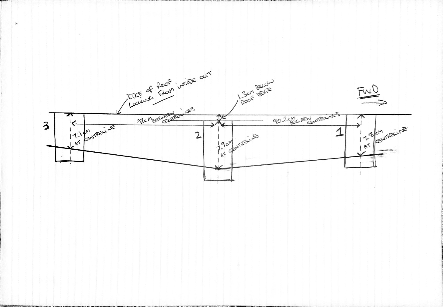

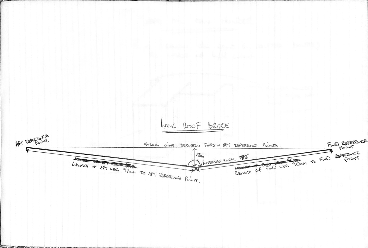

G'day Robin,
I'll just post the pictures here for your benefit and anyone else who may derive some use from them.
The first picture shows the angle I bent the tube to. The tube I used is 3/8" 4130 chrome moly. I picked a reference point FWD and AFT of the bend and ran a string line between them. I bent the tube until I had a deflection of 17mm from the string line which translated to an internal angle of 178°.
The second picture shows the plate positioning on the tube prior to welding. I clamped the 3 plates to a bench at specific distances apart. I then positioned the bar over the top (with the bend in the tube positioned in line with the centre of the middle plate) and clamped at specific distances from the top edge of each plate (measured along the centreline of each plate). Then the bar was TIG welded while in situ.
I worked out the dimensions by clamping all of the components to the my roof and worked out the best positioning.
I hope this is helpful. If anyone has any questions please ask.
Glen

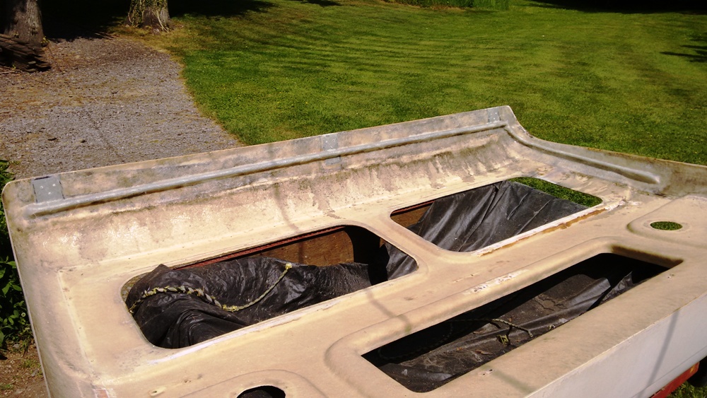

Just finished the strengthening bars and other fibreglass repairs to my roof:
Brought back memories - the smell of resin, sticky fingers, and bits of glassfibre stuck in hands and arms Should really have covered up, but it was such a warm day!
Now to put it to one side while I work on the rest of the vehicle.
My intention is to resin in the curtain rail wood again, paint the inside of the roof white, spray the outside with white paintable stonechip and paint it white or limestone (as per AlexB).
Then, when the rest of the vehicle is ready, re-fix the canvas to the cap using all new brass 4BA nuts and bolts, and refit to the vehicle.
The canvas itself is in pretty good condition, but does have some wear holes/tears at each end of the hinge section, so I'm wondering if anyone has any pieces from an old canvas, a couple of square feet would do, so I can repair it before it goes back on?
