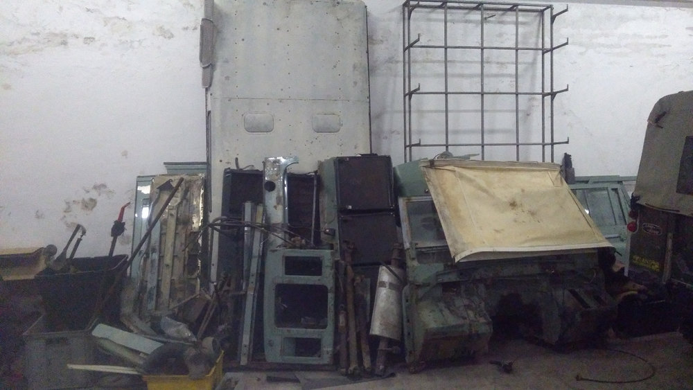

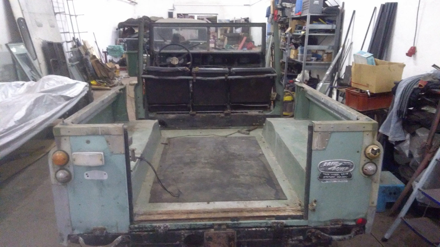

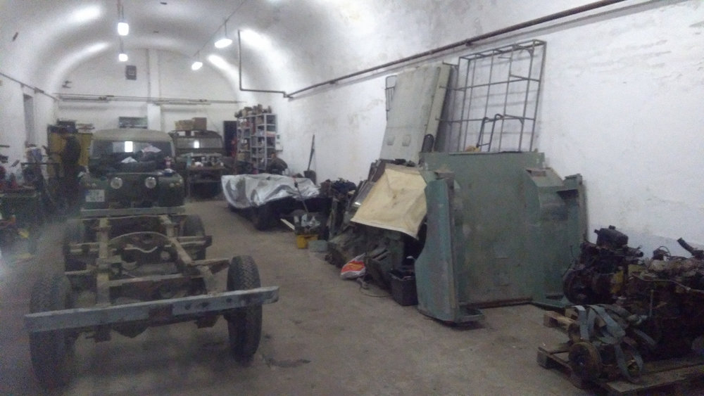

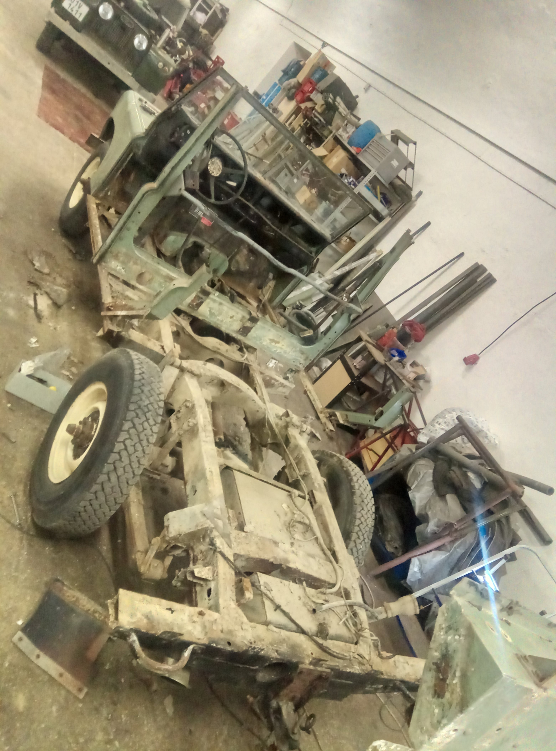

by ericappla » Thu Mar 01, 2018 5:12 pm

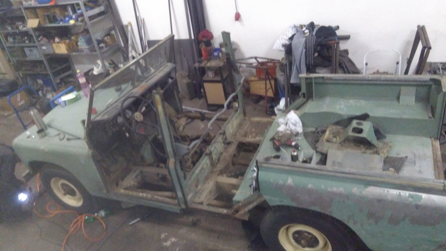

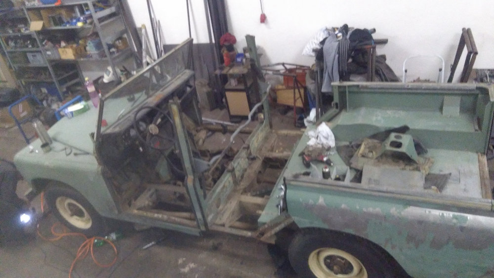

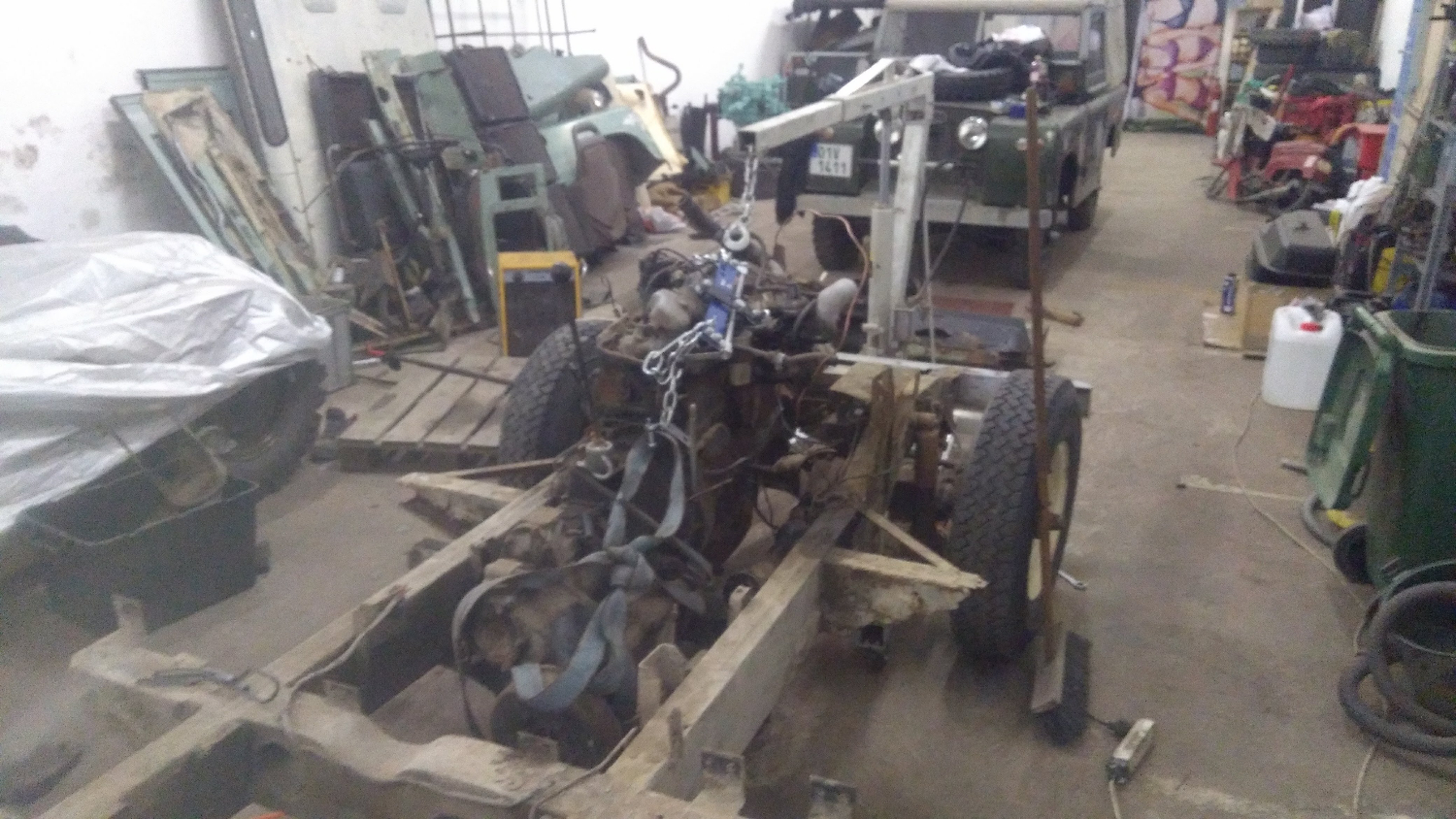

My project is now slowed down due to injury but at least gearbox rebuild is going rather well LT77 and LT230 with 2WD mod is underway. Whats making it complicated is a missing srial number on the main gearbox, the lug where it normally is is scratched to oblivion and theres no chance to decode anything.
There are 3 different tyypes of LT77 selector forks between 1st and 2nd. Any of you have a experience how to tell them apart?

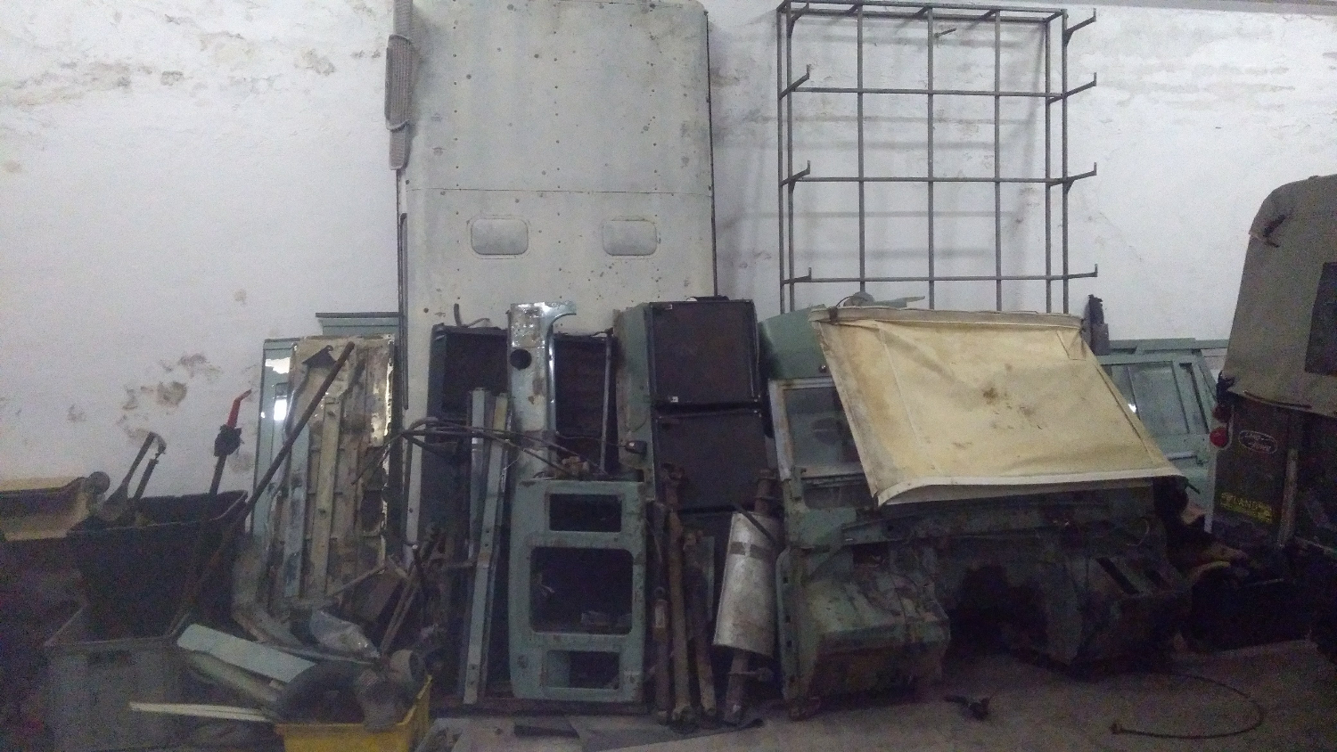

Chassis bulkhead front panel and other small bits are now with sand blasters and will be ready next week.
There is little bit of problem with radiator, fins are really fragile so I neeed to source better example, intercooler is sadly in similar state.
catch you later

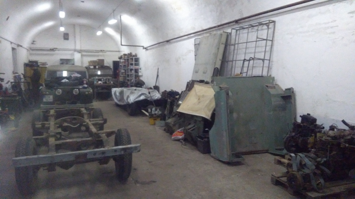

by DrivingDutchman » Fri Mar 02, 2018 4:15 pm
Making great progress there...
WORKSHOP ENVY!!!!
