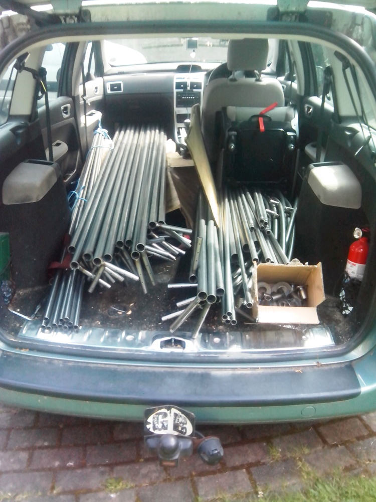

Finally sorted the galvanising out!
The first dip, just over a week ago, was poor
No slag, but bare patches where the steel obviously hadn't been cleaned in acid for long enough.
The production manager was taken aback when I pointed the first couple out, then he had a good look himself and condemned the lot!
His excuse, on behalf of the lads who actually do the work, is that they had such a backlog with the new bath and furnace delays that the first jobs were rushed through.
No excuses - he admitted they had failed and that their QA had let them down, so I left the whole lot with them for another few days and they pickled them again (this removes all the galv as well as cleaning the bare steel) and started afresh.
I'm much happier with the results, but as with any industrial (as opposed to decorative) galving process there are always drips etc. which the finishers have to grind off. That means there are some grinding marks on the tubes, though they have only removed the excess zinc and the galvanised surface is still there, and they will weather in
So, this weekend I'm finishing the bits and pieces I couldn't do until the finished frames were back - internal supports etc. so the first ones should be ready to send out, be collected, or fitted early next week, I hope
It's been a long process, but if I do another batch later I'll know what to expect, and should be able to have a much quicker turnaround.

Yet another setback!
So much for promises, eh?
I left the frames in one of my project vehicles (with rotten Carawagon roof timber so just a tad damp inside!) while I sorted out the bits and pieces; rivets, screws, inside supports etc. which has taken a couple of weeks.
I went out today to start sorting them into sets, ready to package them up, and noticed that in quite a few places where they had ground off the excess galv drips were patches of rust
Despite all the talk at the beginning, and the production manager's assurances that they wanted to get it right, I'm really, really disappointed and thinking of asking for the money back so I can take them somewhere else!
It's not an inconsiderable amount (£195 for the 20 frames), and it's a 50 mile round trip every time I go - 4 times now - so you can imagine how I'm feeling.
So, my apologies yet again for those of you who are waiting for the frames, but I'd rather make sure they were perfect rather than having you call me in 6 months time to complain they are rusting
I'll let you know how things progress.
