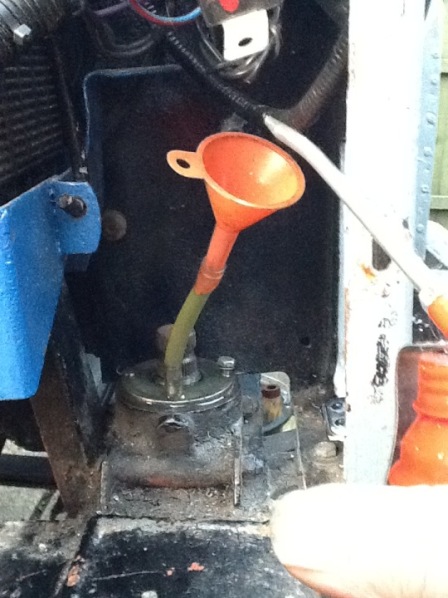

Well the next instalment has been supplied by the other half by way of this photo. Explainations will follow later.

G'day chaps, patience but not regards taking pictures anyway :banghead: so sorry for that but having filled my recon steering box with lubricant i went on to my relay having found myself a long standard size holed grease nipple i proceeded to drill from the threaded part of the nipple up towards the small ball which meant the small spring has now gone and the ball will fall out.
Looking from the front of the truck the set bolt is larger so i loosen that to ex-spell the air the bolt nearest the inner wing is the one i use to fit my grease nipple to the hose to the funnel was a very tight fit but normally i clip it tight the funnel end has previously been warmed then press the funnel in so when cool it is a tight fit.
With the oil having been kept in the bungalow it's a tad warmer and soon seeps between the split bush so although it took a while fiddling my relay now has a nice smooth moment to it which is a lot better than it was having been stood for to long.

G'day chaps, i must say thanks to Robin who has rectified my picture one can now look straight at it rather than laying down to sort of understand what i have done :whistle: and i must say i can't remember my relay moving this well and not leaking oil but then i spent a good while cleaning the tapers up on the main shaft.
