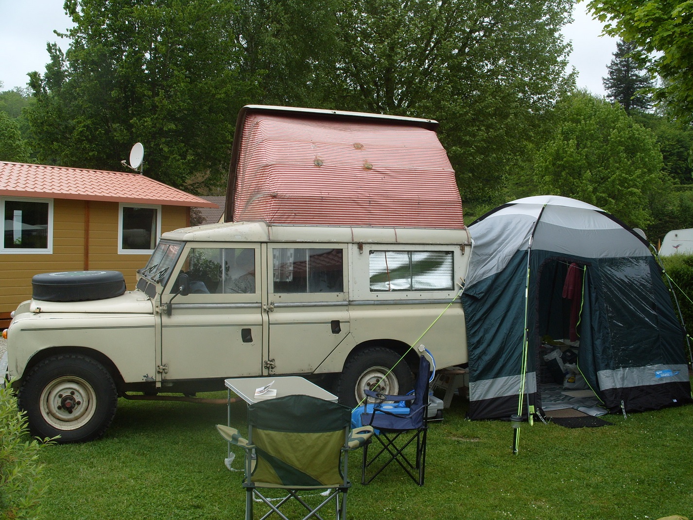

For what I am going to tell you next, I want you to understand that the above serene picture was actually taken later in the week and does not show the continuing gale and frequent showers that loudly heralded our arrival. We waited a little while peering through the windscreen and looking at the pitch next door. What was attracting our attention ? - A holiday chalet in the form of a very secure and warm log cabin !
Yes, I abandoned Dormy and went back to the office to make enquiries. You should have seen how Dianne cheered when I returned with the keys in my hand ! Traitors we did not feel, as the changeable weather continued right through to the Friday morning when we would have to vacate the chalet. It also meant we were completely free to use Dormy to get around the local area without having to mess around with the roof etc. etc.

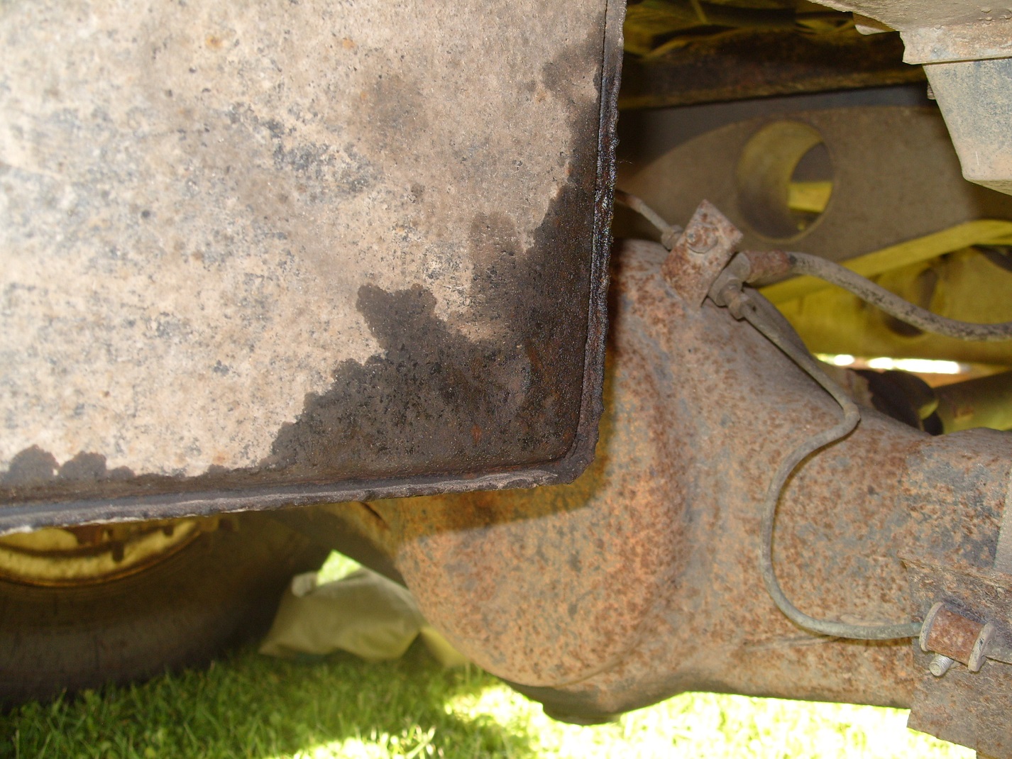

Saturday morning and our story took twist number 2. On opening the rear door into the tent I noticed the smell of petrol fumes. Thinking this might be related to our problems (leaking fuel pipe ?) I investigated, only to discover Dormy's fuel tank had developed a slight leak and the breeze was wafting the fumes into the tent, then up into Dormy via the back door. I now had to move Dormy away from the tent to allow the fumes to disperse.
