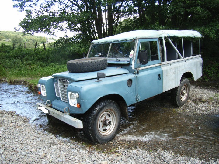

I fitted minibus seats, with integral seatbelts, in Rex the Rat.
They are on a frame which can be cut/welded so that one side can sit on the wheel box and the other on the floor.
You can just about see them here:
Steve (B20wnx on SeriouslySeries) bought two from me and fitted them in the back of his SWB - perhaps if he comes to the next pub meet he'll show you his.
I've still got 4 left if you're interested in a couple
