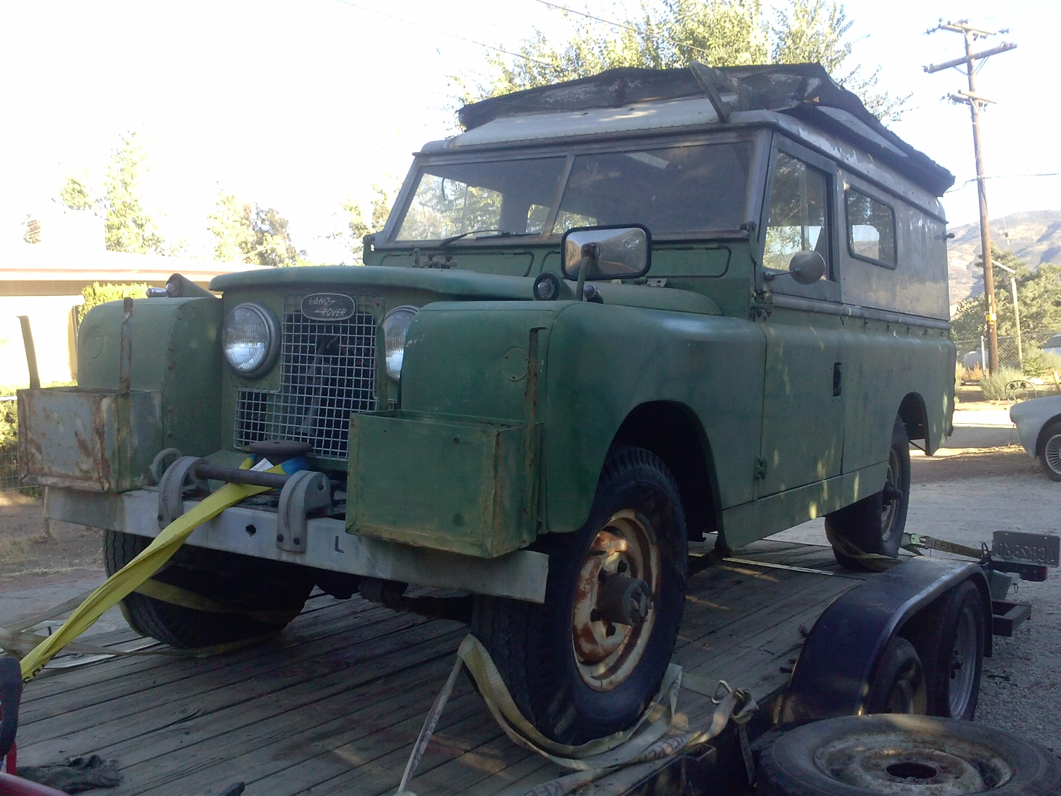

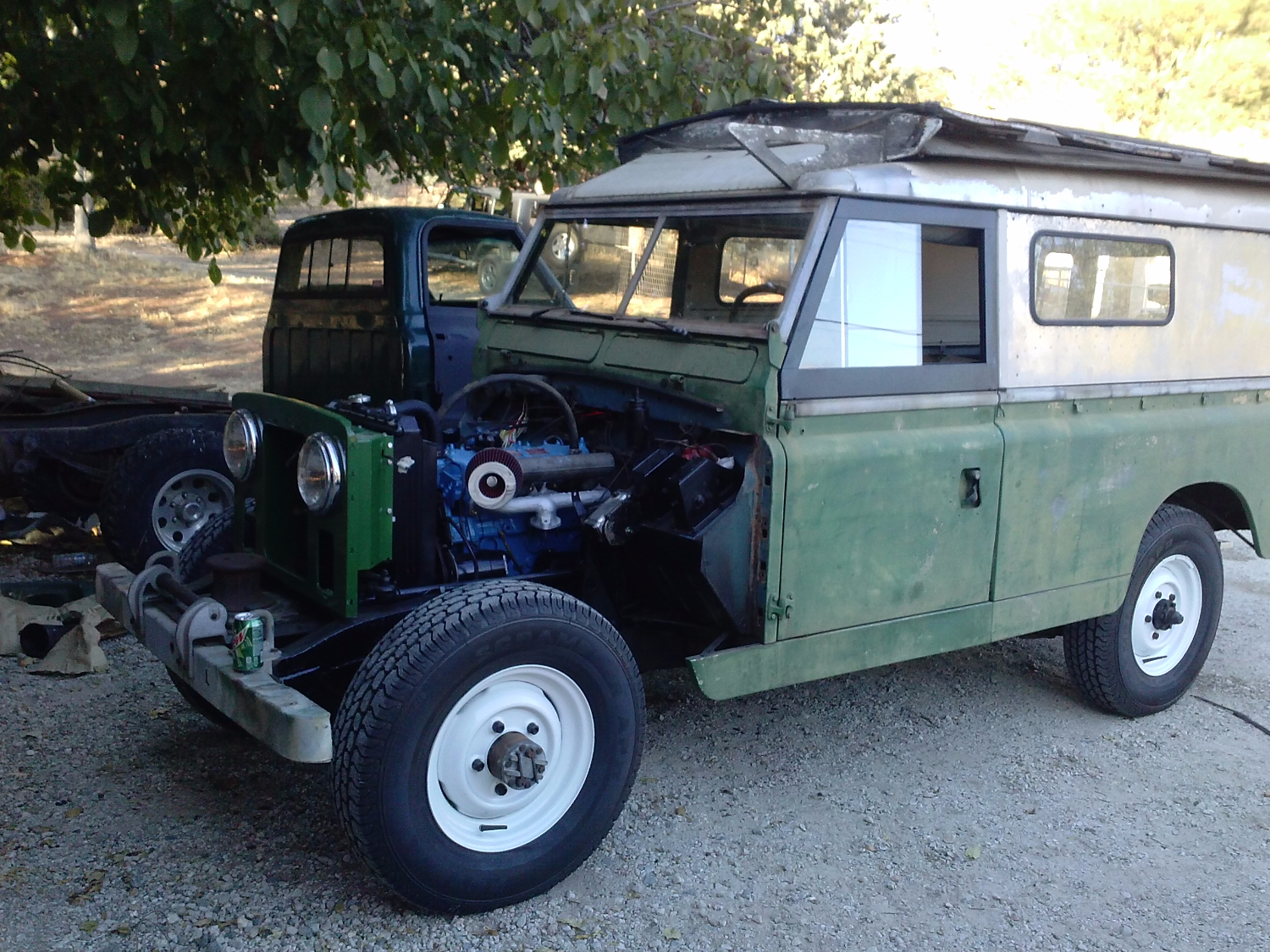

I got my hands on a 1967 series 2a 109" with the 2.25L diesel. I did not know it was a Carawagon until I picked it up. What a bonus.
The kids are looking forward to sleeping in it as after I get it back together.
