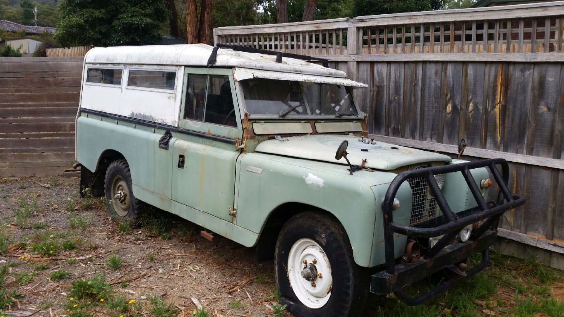

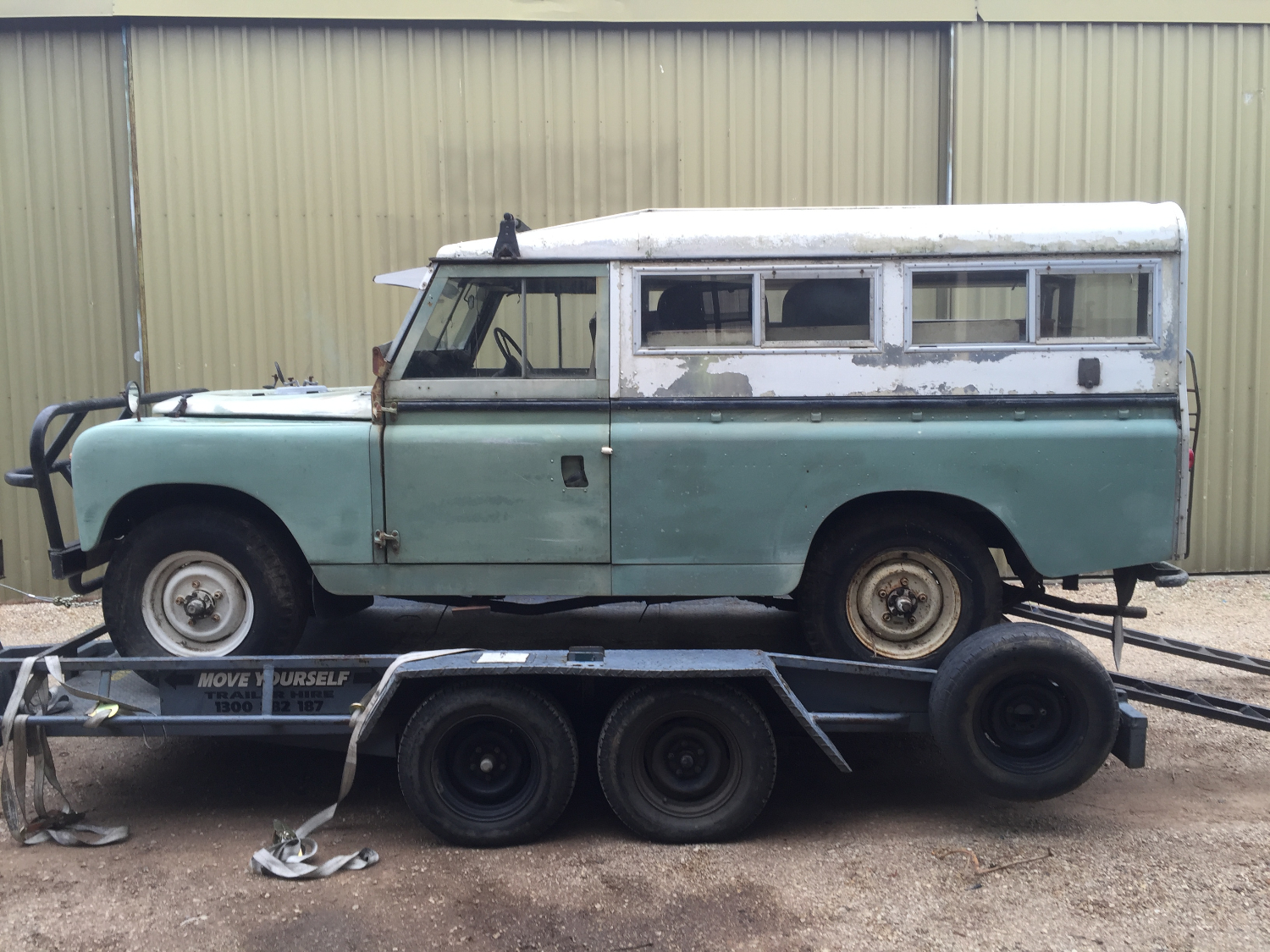

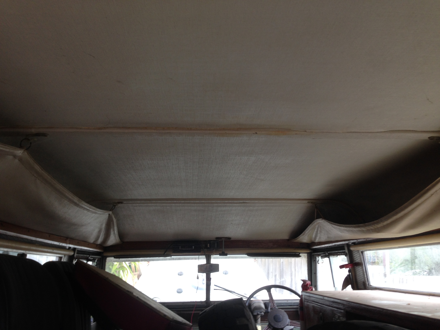

Hi All,
Here is Bessie, my 1963 Series 2a Carawagon. It is the first hardtop I have seen on the forums.
From all reports the car was a one owner vehicle, although that is still to be confirmed as I have no paperwork with the vehicle.
It is very straight, with no rust, aside from some surface rust on the firewall. There is some slight damage on the rear cross member due to a slight impact.

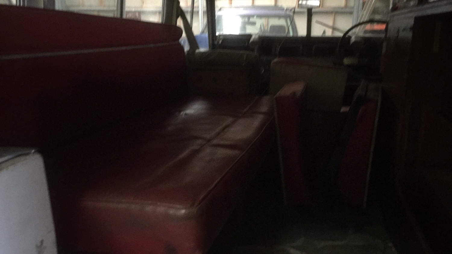

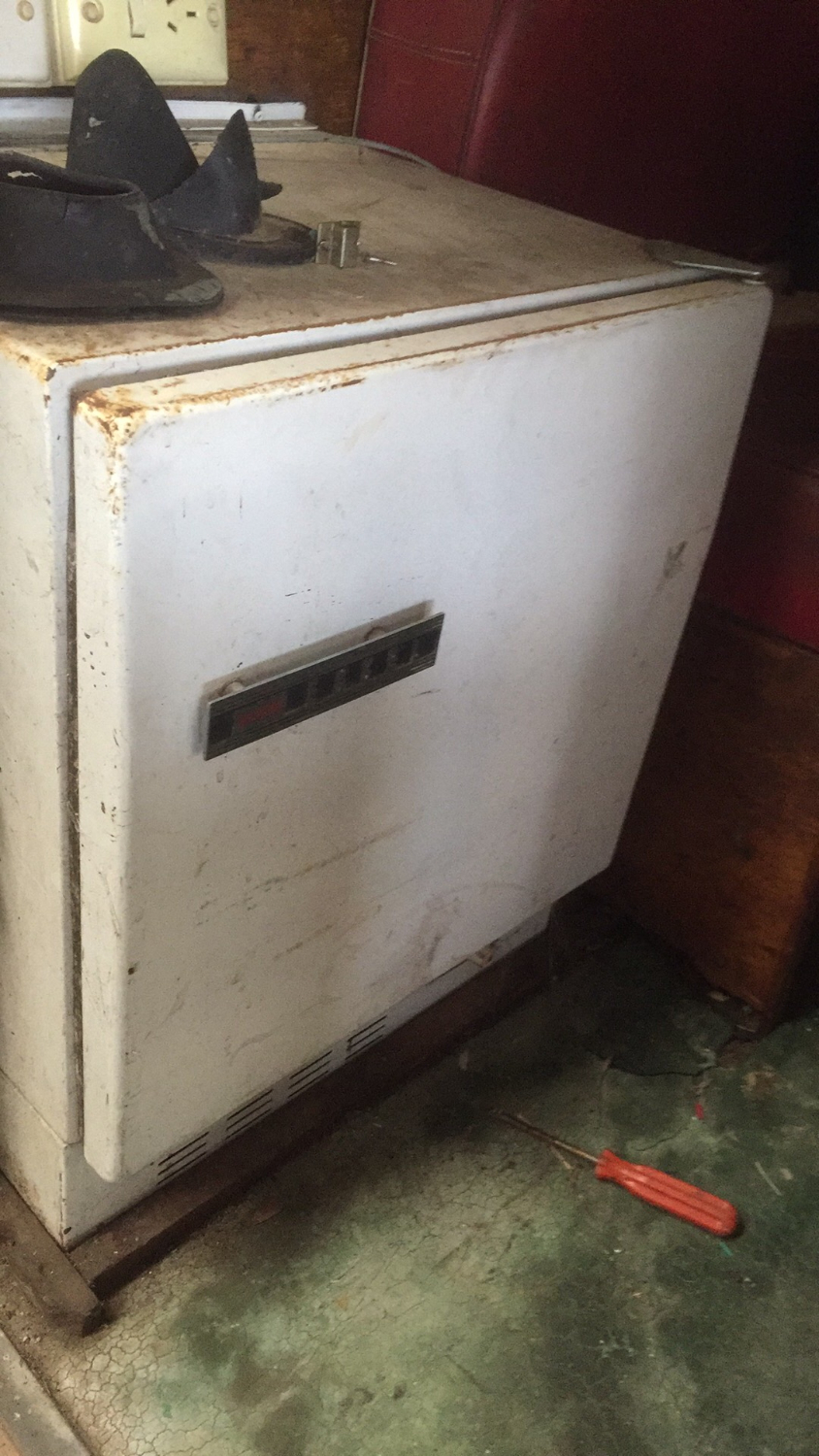

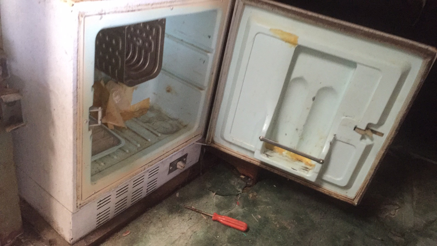

The interior is mostly complete, although it is missing the sink, the legs for the table and the canvas and ridge pole for the back tent, as well as the full length roof rack. The original Engel fridge and stove are still there, however both require refurbishment.

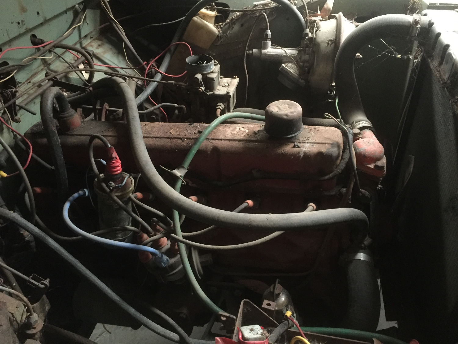

All rubber seals are perished, the engine is a Holden/GM 186 6 cylinder unit, however it originally had a 2lt petrol. The Holden engine conversion was very popular here in Oz during the 1960s and 70s.
I am having the engine checked out and brought back to life so that the old girl can be moved whilst the bodywork and interior can be refurbished back to original condition. This will be after I have finished the RHD conversion on my 110.

Interesting that your cupboards and mine were standard height - must be a bit of a squeeze preparing food etc. on the worktop.
It looks like your cupboards are the same (or very similar) to mine - hinged rather than sliding.
If that's the case, the middle cupboard door comes out and slots in horizontally to make a table, no legs required unless some have been added so it can be used outside.
The 'sink' should be a washing up bowl which should slot into the top of the cupboard under the tap, and there would have been 2 or 3 water containers in that cupboard as well with a pipe from the tap just pushed into one of them.

I agree that the workbench height is a little high, although probably all of the preparation may have been done on the table.
The table in mine has been poorly repaired in the past with slide bolts put on the table surface when the original ones broke. Will fix that in due course.

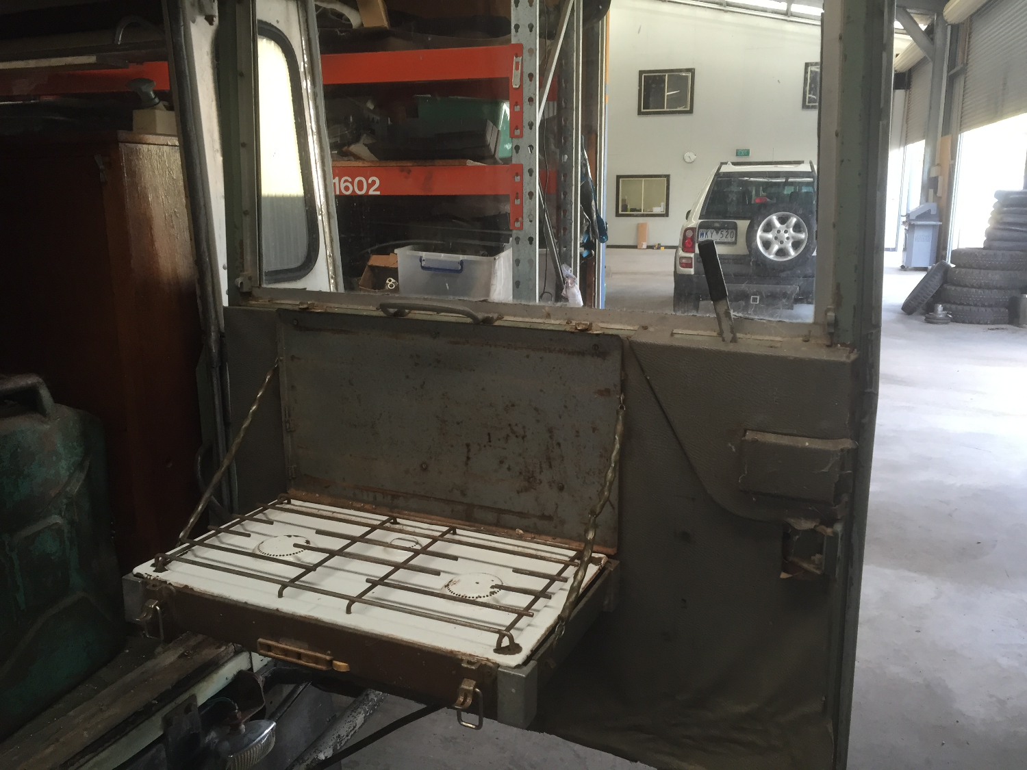

Very nice project, is the cooker on the rear door a standard fitment on the Carawagon?
I will be making e new interior in my ”Dormobile”, since I only got hold of the roof, and I will probably fit the cooker on the rear door, so save some internal space.

Cooker position was customised according to what the customer wanted.Klusenhusen wrote:Very nice project, is the cooker on the rear door a standard fitment on the Carawagon?
Regard Jan
My current on-the-road Carawagon has it inside, above the fridge.
One of my project Carawagons has it inside, the other has it on the door, all original fitment.
Patrick's is also fitted on the door on his Carawagon so between us we have two inside and two on the door
One problem with having it on the door is that unless you always put up an awning, any wind can blow them out especially if trying to cook on a low heat.
It is possible to cook inside with a cooker on the door but it is very close to the floor and you cannot open the back door without folding the cooker.

Ah!, I had thought about protection from the rain, but of course wind will also be an issue.
I will have to think it through again.
