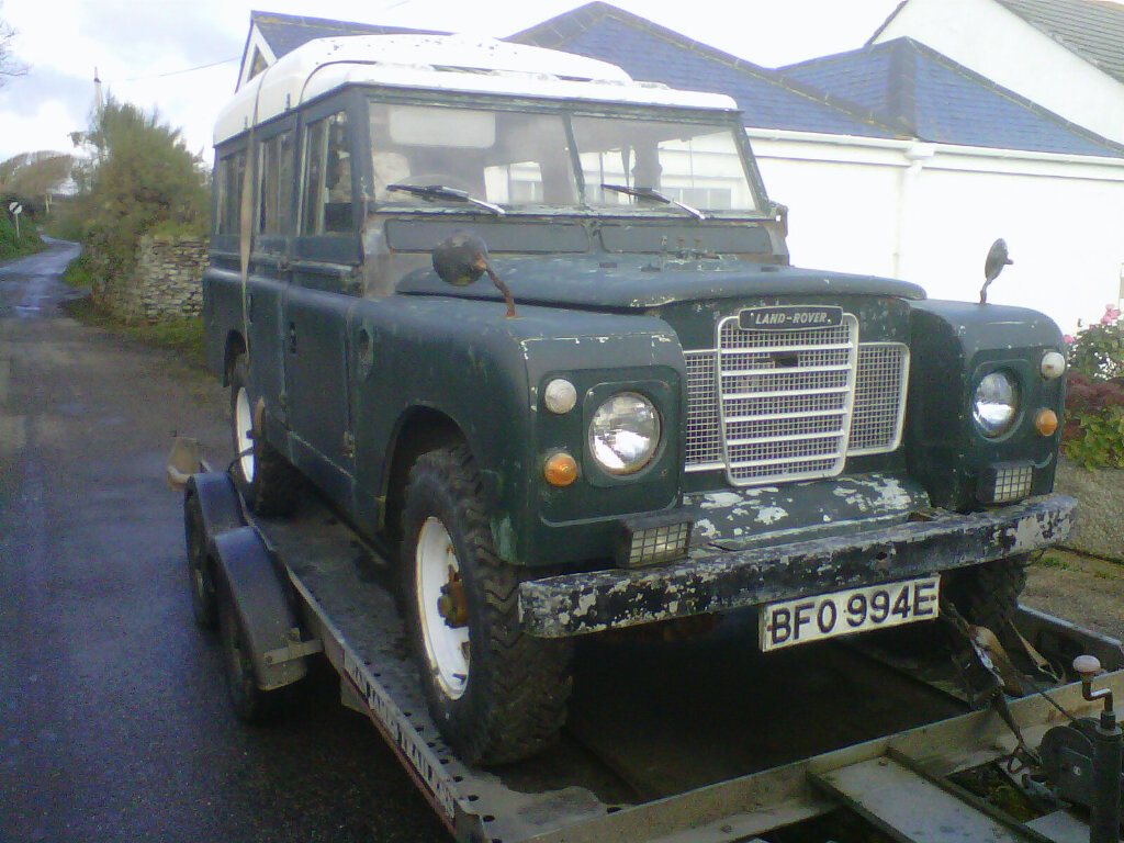

After a delay of a few years I am finally starting my 1967 Dormobile restoration. It really needs to go on a new chassis so I am getting one from Richards Chassis very soon. However, they have asked me for pictures of my current chassis so they can see if it is different to standard. I always thought that the Dormobile was built on a standard 109 chassis; can anyone confirm this for me before I order mine? Thanks for your help, Martyn.

Looks like another rust bucket has been saved. Well done
Do you have all the interior ?
Where are you located ?

Fortunately it is fairly complete. Has the Dormatic seats, bunks and table but lacks any furniture such as wardrobes or sink unit. I should be able to sort something out though even if I have to make my own stuff. Incidentally I am based in Shropshire.
