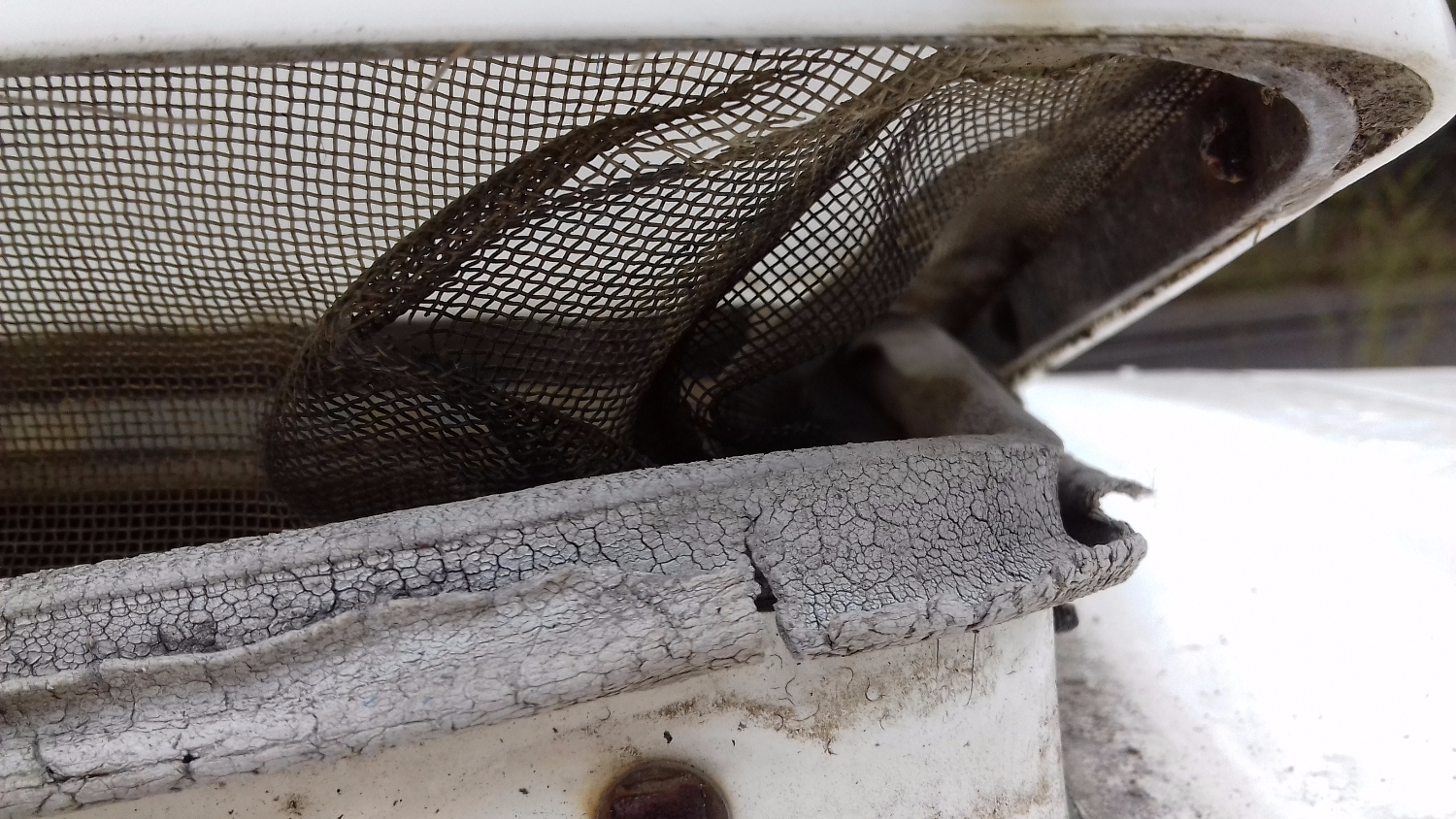

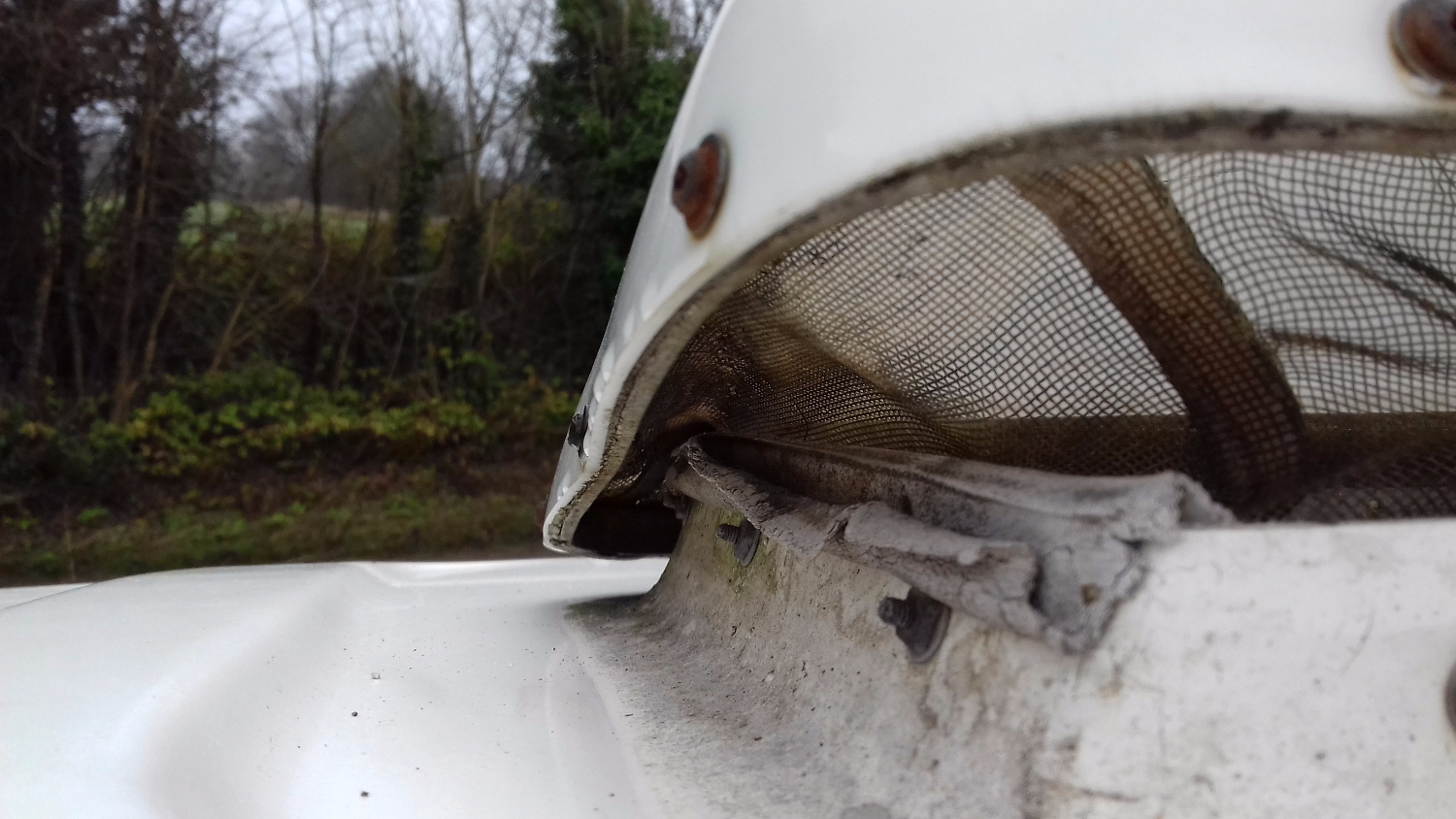

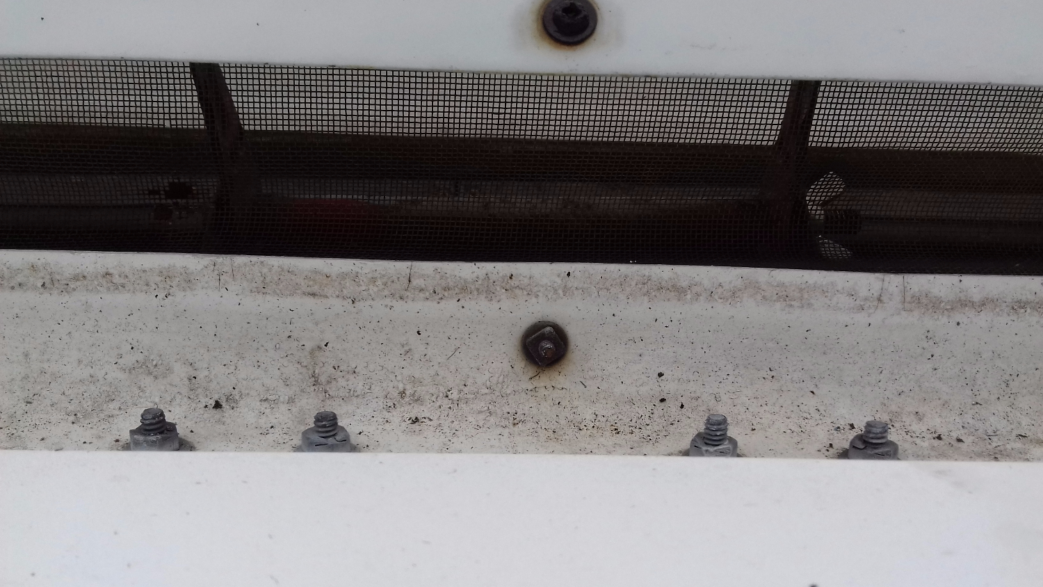

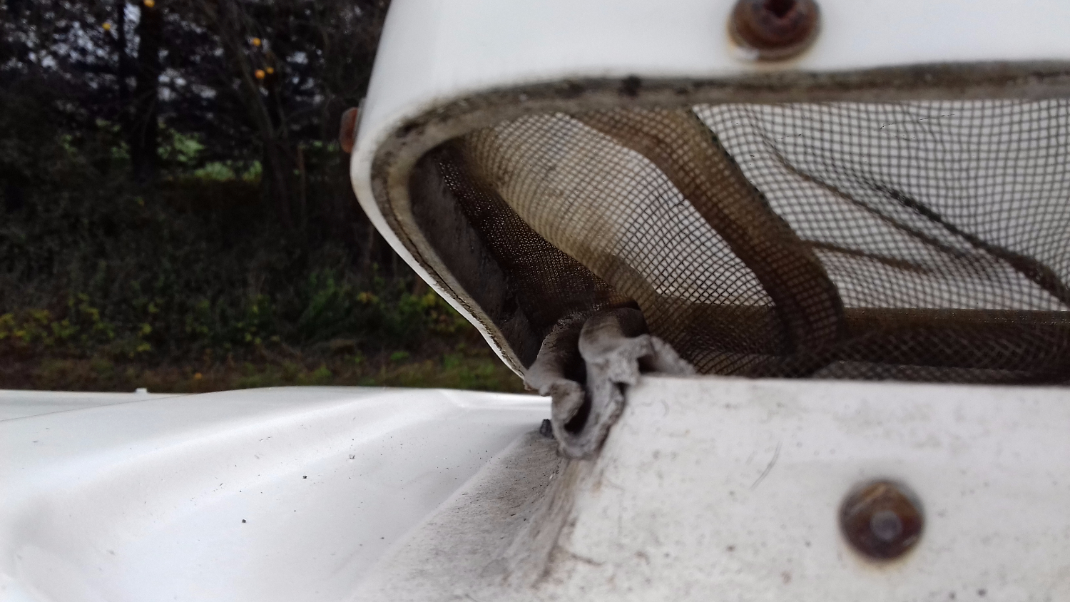

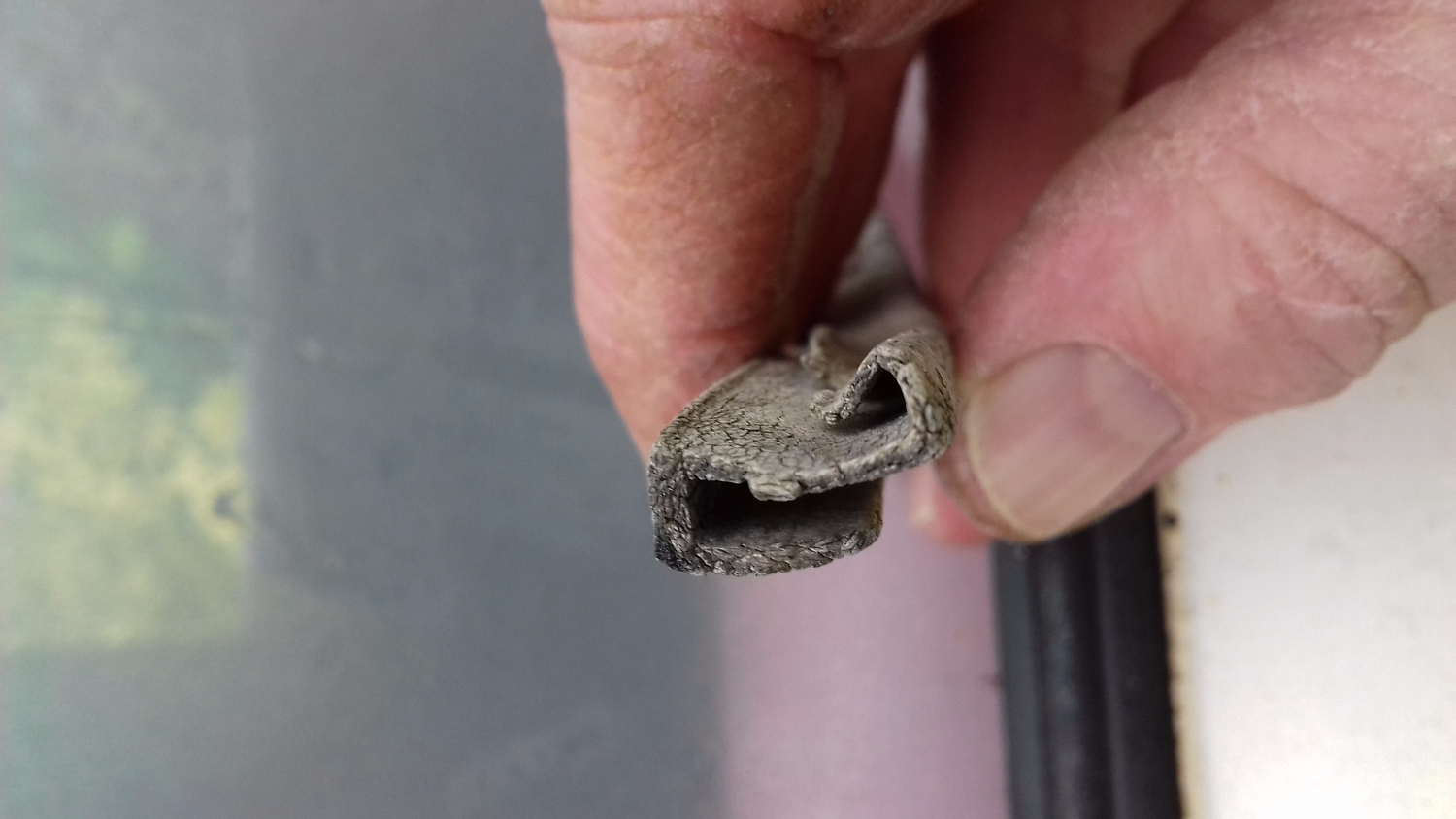

The roof ventilator seal on my Dormobile is somewhat past its 'sell by' date.
Not sure if it is the original fitted by Dormobile. Most likely its been changed by one of the vehicles previous 17 owners!!
Please see some attached photos of what it looks like .
Not even sure if the seal should be on the roof cap up stand or on the ventilator itself?
Any help and advice greatly appreciated please.

Ok Dormobile sell the seals but not even they show what the profile looks like or how it fits.

The seal looks like the seal I have on my Dormobile. I bought it from Dormobile about 8 years ago. Its feels a bit floppy and you wonder if it will work, but no water has ever come in. Just pushes onto the roof upstand.
