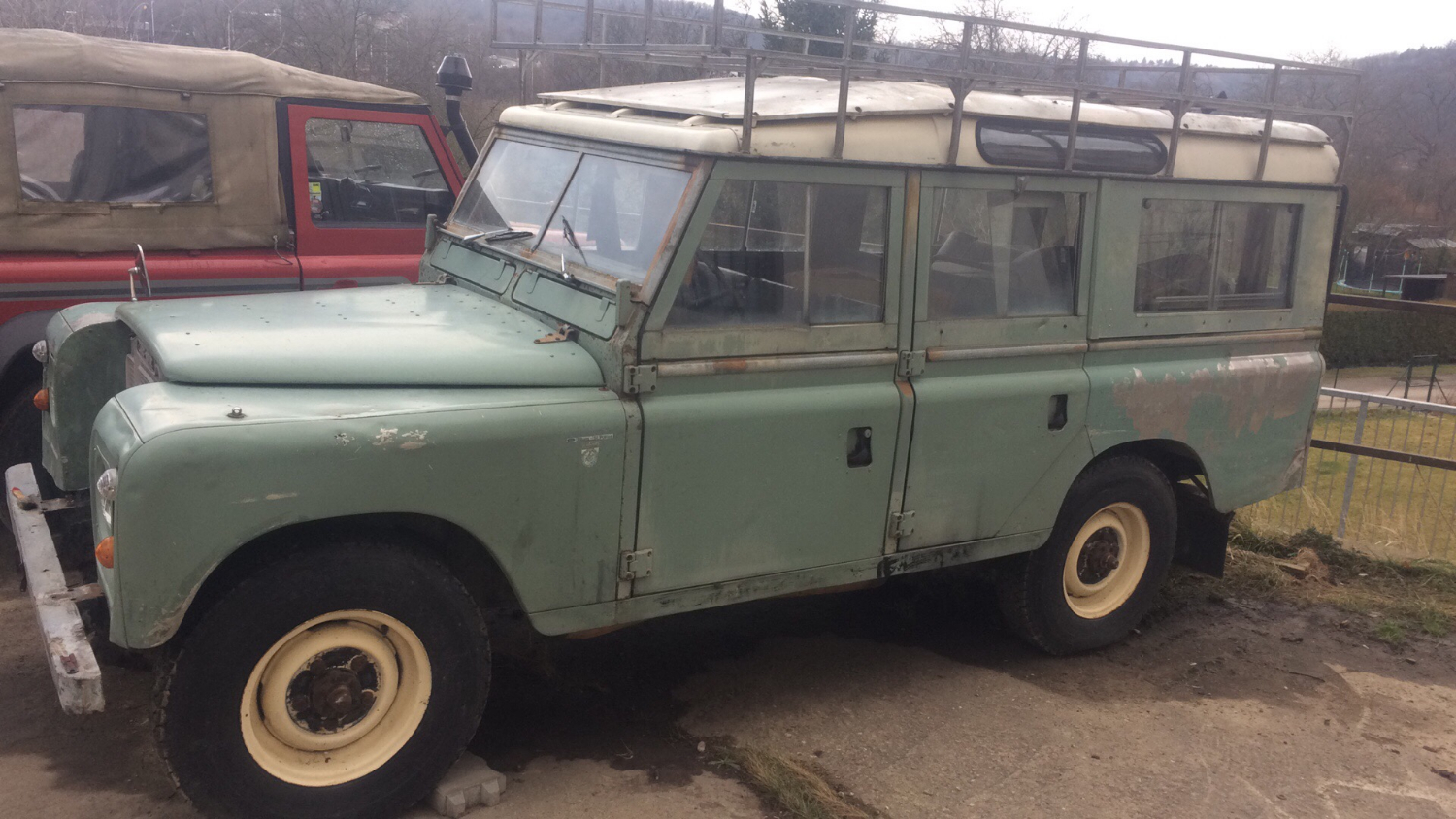

Hello folks,
Ill start this thread to share my plans and progress with my camper conversion of 1975 series 3 109 station wagon
It is a 6cylinder model and I plan to replace the engine with 200tdi out of discovery along with LT77/LT230 from 90 to allow for better fuel economy on the forthcoming travels.
Planned drivetrain setup is following
engine 200tdi
Gearbox LT77/LT230 (defender ratio or Discovery ratio)
Axles - series Rover axle front and Salisbury at the back. Differencials ratio 4.7:1
TIres 7.50x16
I am still not sure if I should use discovery or defender LT230 as I have both to choose from
With regards to Brakes setup I plan on retaining the 6 cylinder setup with wide shoes/drums at the front.
Springs I will retain original 6 cyl front springs but replace rears with 1Ton springs and associated shock absorbers
Steering will remain standard series without the power steering modification.
With regards to actual camper setup I will post my ideas later.
