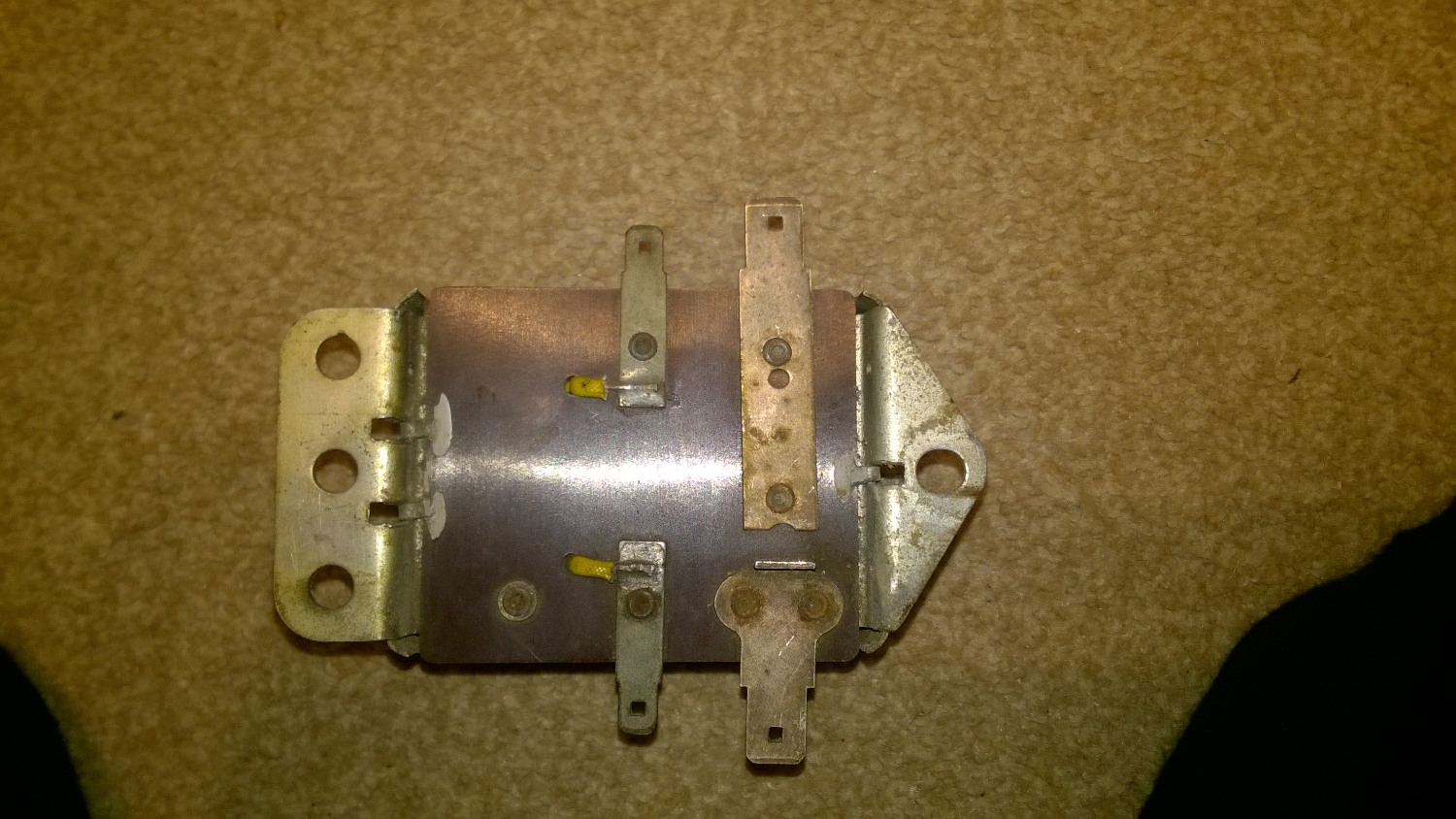

My Searle Safari has the capacity for two batteries, one in the engine bay and the second under the passenger seat. The space under the seat is currently unoccupied. Also in the box of bits that came with it is a Lucas 7RA 33335A split charge relay. I have also read that Searle offered an extra battery with split charge system as an option.

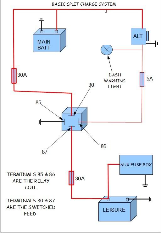

The Lucas 7RA 33335A is a heavy duty relay, switched on by the output (charge light terminal) of the alternator.
Very simple and the way things used to be done.
One of the problems with that type is that your aux battery is switched in to the charge circuit as soon as you start the engine.
If your main battery needs charging it won't get the full charge current as your alternator is charging both.
Modern split charge relays are voltage sensing, which means your main starter battery is charged first, then, when it is fully charged, the unit starts charging the aux battery. They also don't need to tap in to the alternator charge light circuit.
If you want to use the original relay, HERE is the basic diagram - If the terminals on your relay are marked differently, let me know and I'll see if I can work it out.

My relay has two large terminals and two small terminals. The large ones are marked C1 and C2, the small ones are marked W1 and W2. I guess the W1/W2 is the switch and the C1/C2 is for the connection between the positive terminals on the batteries.

Ah, ok, the 'old' Lucas terminal designations!
W1 & W2 are the 'windings', ie, coil, to operate the relay.
C1 & C2 are the 'contacts'.
So, connect W1 to your alternator charge light lead via a 5A fuse, and W2 to earth.
C1 to your main starter battery +Ve via a 30A fuse, and C2 to your auxiliary battery +Ve via another 30A fuse.
The wire to the alternator charge light lead and to earth can be thin wire, 0.65mm² or 1.0mm² or as it's carrying a very small current, but your battery leads need to be rated for at least 42A, 6.0mm².

Re: Searle Safari Split Charge
Hi Steve,
The alternator W terminal is at 0V until it starts to produce charge, then it goes to 12V and so will energise your relay..
The reason the charge light on your dashboard comes on when you turn your ignition on, and goes off when the alternator is 'outputting' is that the other side of the charge light is connected to 12V positive, not earth as you might expect.
This 12V positive through the charge light provides the initial 'exciter' voltage to start the alternator output. Once it starts to output, the W terminal has 12V on it from the alternator, cancelling out the 12V on the other side of the charge light and so the charge light goes out as it's got 12V on both sides - and if you follow that, you're good to go
Not really explained well, but the basis is that you connect W1 to the alternator charge lead on the alternator side of the charge light, and W2 to earth
