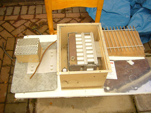

Another option is an underfloor heater, usually used in old folding campers and trailer tents.
These fit into the floor, (yes, you do have to cut a rectangular hole in the floor!), and heat using propane or butane, whatever you are using for cooking.
They are sealed room units, with the flue inlet and outlet exiting below the floor, BUT, they are no longer fitted to new campers due to new EU rules as you can burn yourself if you stand on the grill for any length of time with it turned up high - perhaps not the best option if kids are involved.
Here's one just finished on ebay - it went for over £200, but that was a brand new one.
Ebay listing HERE
I've just bought one for £35 from a guy who was dismantling a camper :wink:
I'm not sure yet whether to fit it to my new Carawagon or my old Dandy folding camper!
A big advantage of the underfloor type is that most don't need any power - they just need gas :gold:

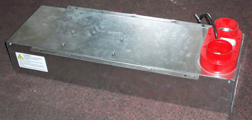

The other type is similar to the Propex unit, made by Whale, and again fits beneath the floor, but this time with just the vents showing.
Ebay listing HERE
These can be powered from just 240V if you are plugged in on site, or just gas & 12V if 'wild' camping.
