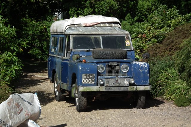

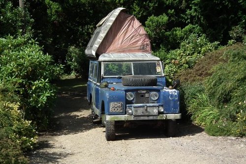

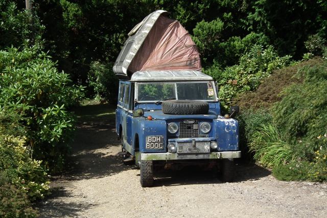

I thought I would put up a couple of pictures, of my recently acquired Dormobile. It is in a pretty bad way, and will be needing a new chassis at some point in the next few years, but the aim is to hopefully get it running and on the road before that. I have all the specific parts, wardrobe. cooker, seats, table and roof (in fact, I have two roofs..), although the table has all but rotted away, so will be a template. It has had an interesting life, having travelled "all over the world", (unfortunately, we don't know exactly where [yet] ), been at Poole and Dorset Adventure Centre, police cadet training, mountain rescue
. It isn't completely original, the original engine did 200,000 miles, and this one has done 150,000... many bits have been changed over the years, but in a way I am quite glad
. I feel less worried about changing bits knowing that they have already been changed

Lovely, nice find Ant!! Looks pretty solid, don't rush to a new chassis, I thinks Micks was more or less snapped but repaired solid now... That LPG tank is not going to improve the usability though....

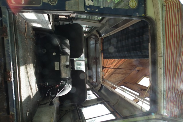

Yeah, a few have been turning up. The chassis, while it hasn't snapped, really isn't great in places. I stuck a finger through the rear crossmember, for example, but I think the middle of it looks OK. The long term plan I have is to get as many of the steel bits as possible galvanised and painted up, or thoroughly derusted and painted up, so I don't have to worry
. The LPG tank is one of the things that annoys me greatly; I am really happy it has been converted to LPG, because that was one of the things I was thinking of doing, but it is really in the way. Underfloor tanks were hundreds of pounds extra, so I hear, and it was being used as a daily driver, so I think cost took precedence slightly. I really want to replace it with underfloors, if I can work out how, so I can recline the seat and fit the units again...
However, that can wait until I have it running, and hopefully MOTed, because while it annoys me it (probably) works, so can wait. Out of interest, does anybody have a rough idea of how many Dormobiles are still around?
