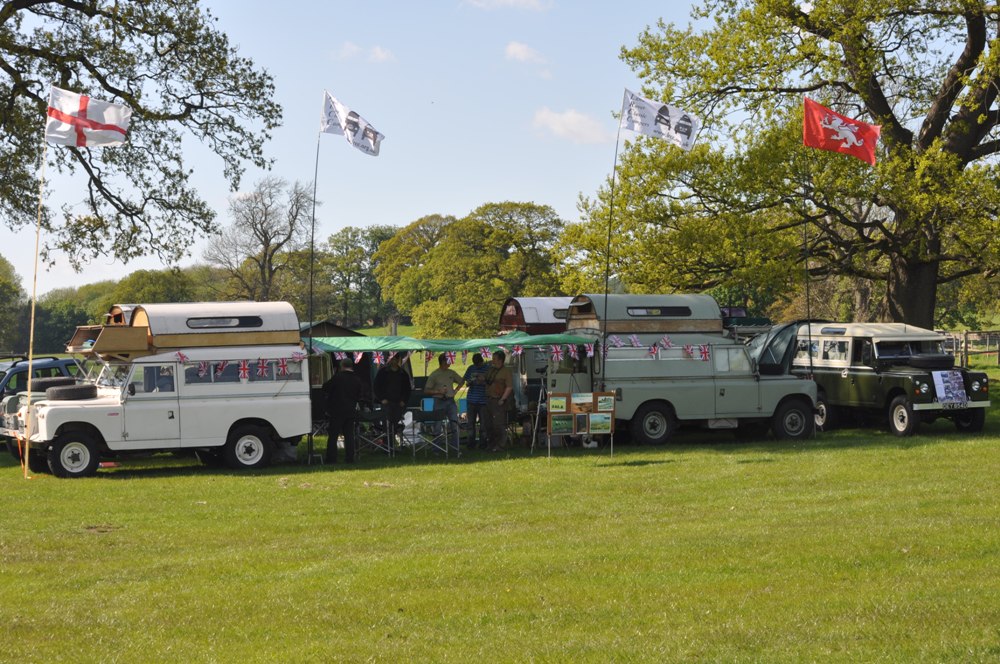

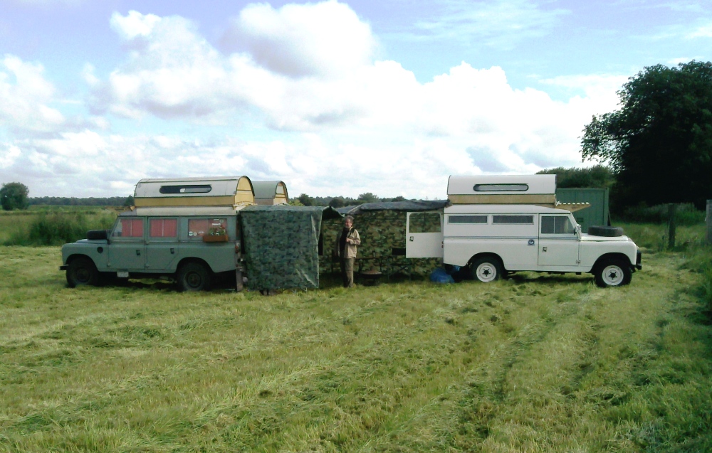

I'm sure most of you have seen pictures of them in use at shows etc. where we usually park back to back, but here are some pictures for those who haven't.
We tend to use cheap tarps, around £5 to £10 on ebay for one big enough to go over two Carawagons back to back with both awning poles extended, and down one side, but one of our members has had a copy of the original canvas awning made.

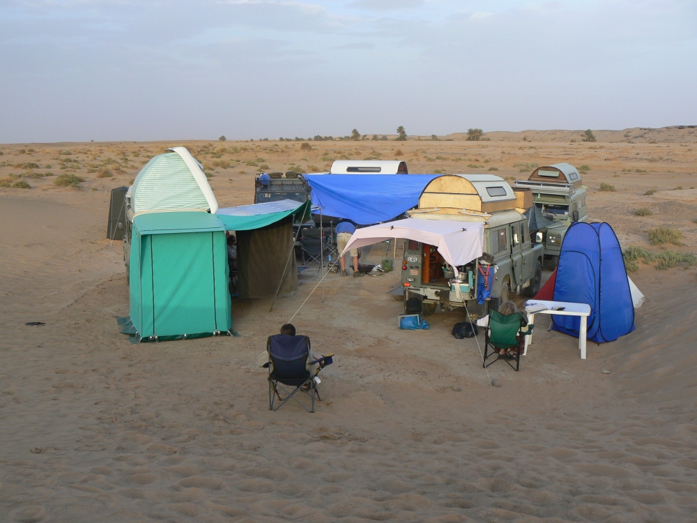

In Morocco we used a thin cotton sheet over as a sun shade - the pink one in this pic!

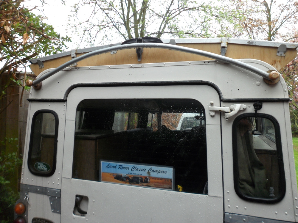

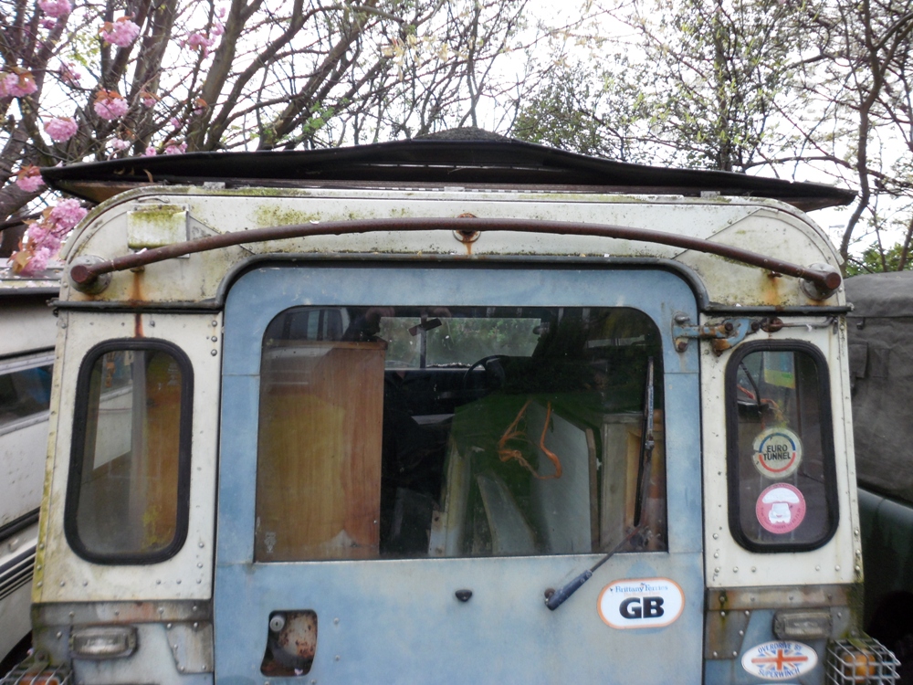

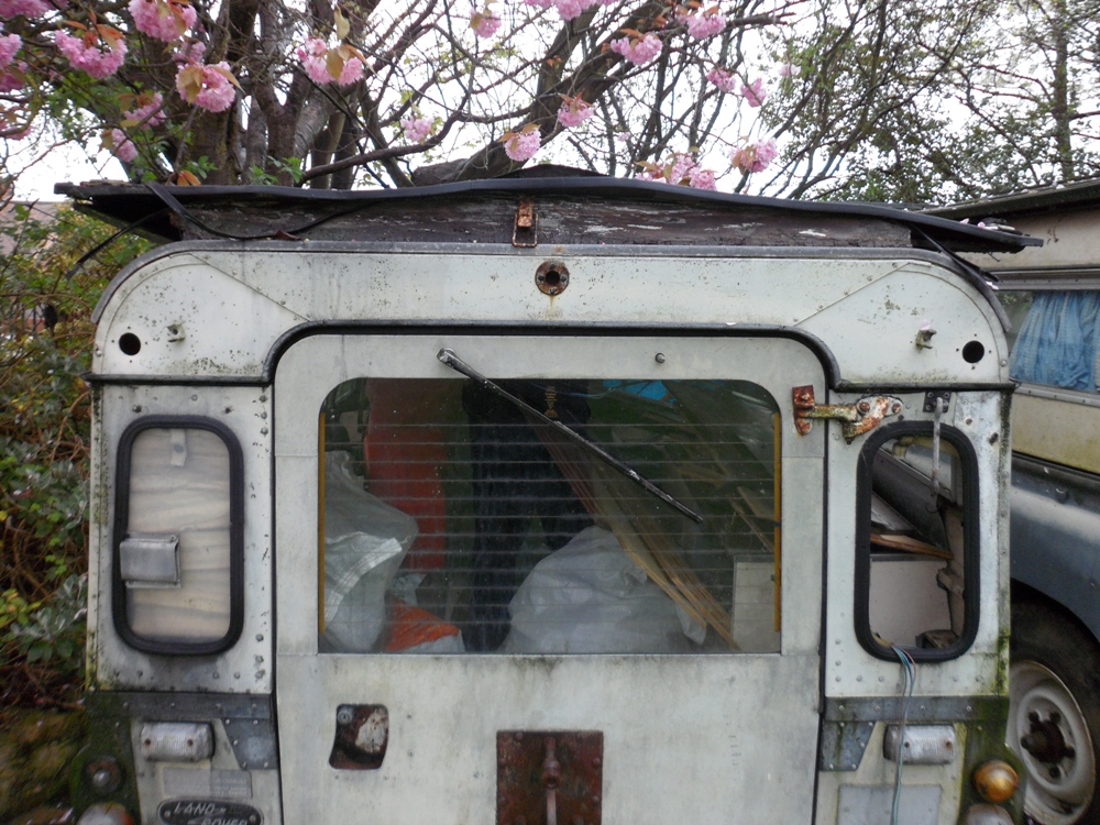

Just for info, here are a few (poor-ish) pictures of awning poles:
Original with frame and fittings removed:
Original (but rusty!):

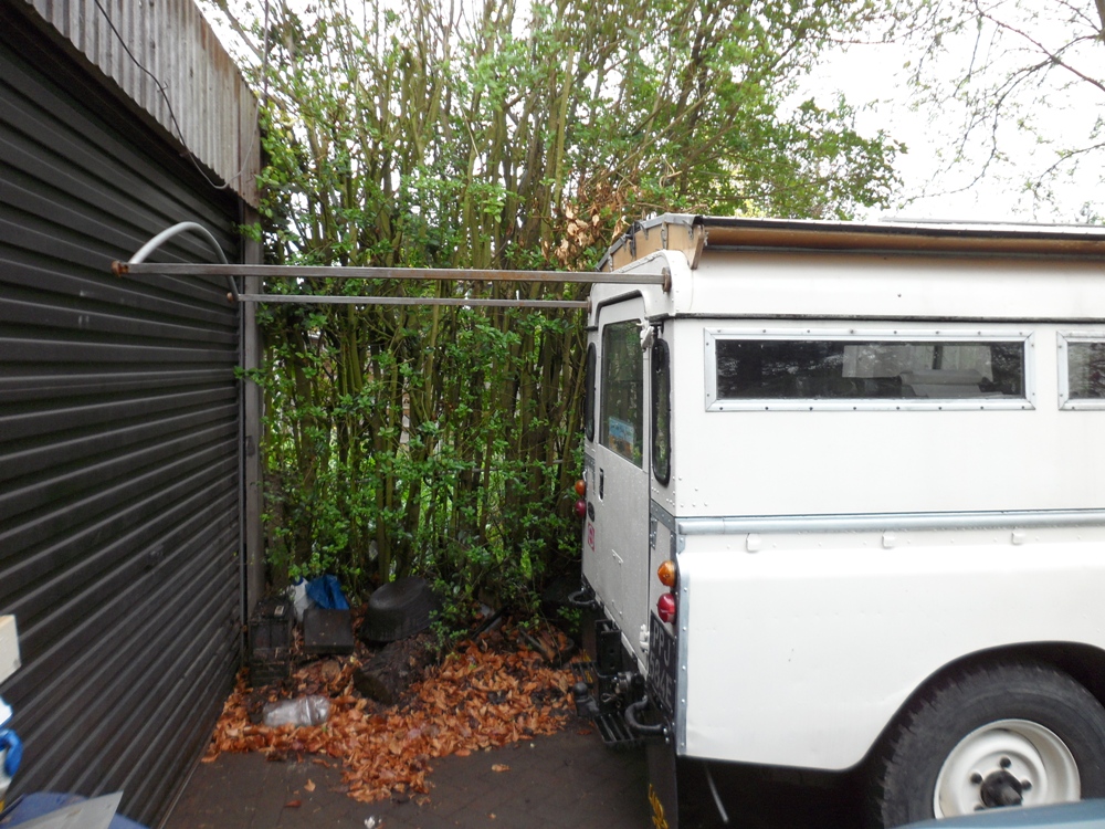

Temporary frame set made from square tube (it's what I had laying around :whistle:) and higher arch:
Temporary frame set pulled part way out:

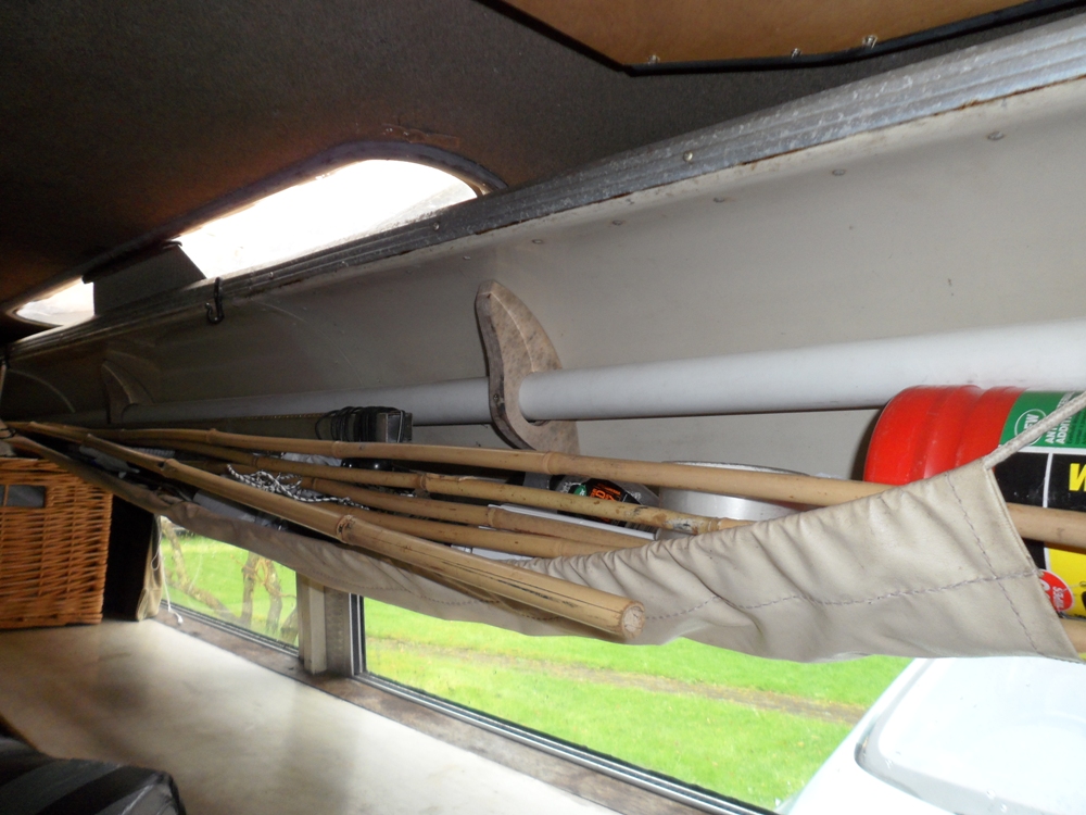

Inside, showing tube and supports. Please ignore the paraphernalia in the paraphernalia pockets!
You might notice the temporarary set I made a year ago for my Carawagon has a much higher arch than an original frame, and the side poles are mounted higher in the roof.
The idea is that it gives more slope to the roof sections of the tarp, causing less rain pooling, and more headroom under the sides of the frame.
However, if you do not have a Carawagon lifting roof it would look silly sticking up above the roof line, so the original arch shape and mounting position will be used on the new ones, unless anyone has a preference.
I made a set from the square tube over 3 years ago for Patrick's Carawagon and they have caused no problems, but the new ones I make will be made from round tube, the same as the original ones.

The centre pole detaches and, in the Carawagon, is stowed in one of the paraphernalia pockets.
I was thinking of perhaps some sort of straps, velcro, around one of the inside pipes to store the centre pole on a non-Carawagon vehicle?
I also thought of finding a way to store it inside one of the side poles, but then it gets a bit complicated re. end caps, stopping it sliding out into traffic :aaagh: and retrieving the centre pole from inside the frame pole :shrug:
