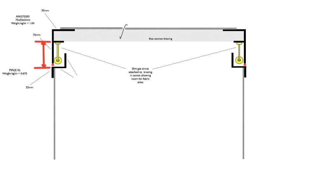

I gave it some thought and realized that for the DIY approach there are two major 'construction' hurdles to overcome and one 'practical' hurdle to consider:
The construction one is that doing it on the drive at home with limited fabrication space & equipment means that the curve upwards at the back door, and the curve over the windscreen will require specialist skills to properly fabricate the shaped metal needed to accommodate the curves. And the practical hurdle is that removing the old roof to install a lifting mechanism to lift it will mean having the vehicle off the road for some time, which is a problem for me. And you need the means to easily hoist it too, which I dont have, and as I'll be doing nearly all of this on my own it needed to be manageable......

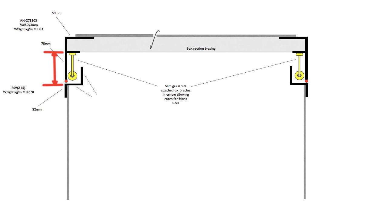

Gave it some more thought and then realized I should just leave the existing roof intact, and build up out of the existing gutter line. Then bolt the 'new' roof to the curve of the old roof at the sides, and bolt through the alloy front and back, and fabricate a lifting mechanism above that on clean straight lines - ie not having to worry about curves at back door and windscreen.

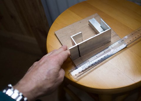

I did a wander around the web and eventually found two easily available alloy extrusions that would allow the roof to work - one a Z section that gives a water-resistent upstand to use for the lower section, and the other a long L section to use as the lifting bit. Crucially the combination of these two sections together leaves enough space between their vertical faces to allow the fabric sides to pull inside when closed. The various early drawing are below - the design 'evolved' considerably as it progressed so things like the roof attachment and roof rack design are different in the final version.

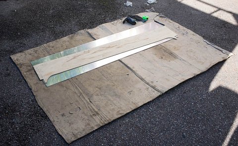

Bought some sheets and had it sliced:

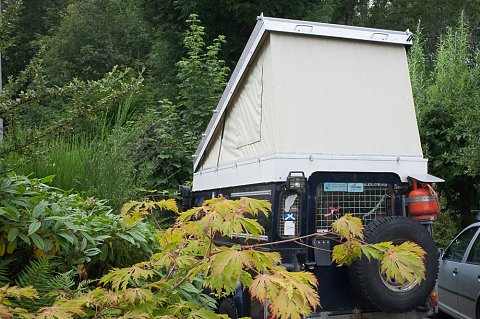

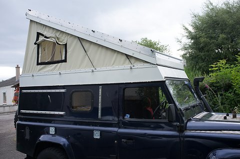

And exactly 1 year later (virtually to the day - started last July, got the fabric on this July) I got the thing fabric sided and working:
I've still got a load to do - more electrical work, small kitchen details, back door stays, a rear awning to be sewn up, and at least a dozen other things, and I've designed it so that I can instal hard sides made from Dibond alloy sheets (bought them last week, scratched so reduced price) and the idea is that they can be clipped in easily in grotty conditions/winter use.

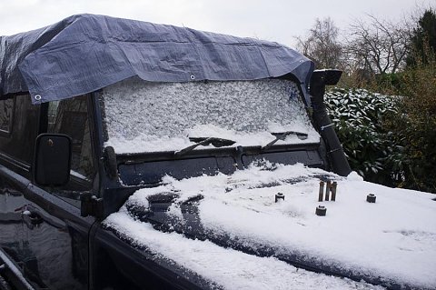

It was on my drive from July until December working in these condition (north of Scotland):
But a friend took pity on me and loaned me some space in an unheated but dry(ish) barn that's used as a workshop, which I kid you not was colder inside than it was out. I was in there until April, with three layers of fleece on and a permanent drip on my nose.I wont kid you - it was bloody hard at times, frustrating, swear-inducing, and almost drove me daft (and if you read the whole thread you'll appreciate the events of November were rather unexpected).

- Side panels and bug netting opened.

And here's one of the drawings I forgot to add above:
