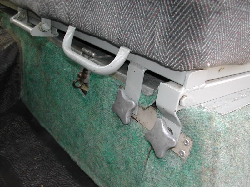

Hi Ian, my dormobile is a 1976 conversion, although fitted with a double passenger seat it also came with a single front passenger seat. I'll have to take a few pics of the front seat assemblies.
Here's a pic I found on the dormobile forum of a passenger seat , pretty sure it's a 2a conversion but is slightly different to mine. Maybe they had different makers of the seat assemblies :shrug:

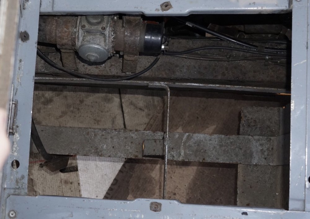

Here are the promised photos.
Bear with them as the seat is not fitted at the moment, but you will get the idea.
Hope this helps.
Re: Walter the Dormobile
Post by DrivingDutchman » Fri Feb 06, 2015 4:43 pm
To answer the question on the issue what should below the drivers seat...
There should be a bracket assembly for the gasbottles. The hatch gives also access to the fuelpump mounted on top of the chassis rail. It fits 2 bottles.

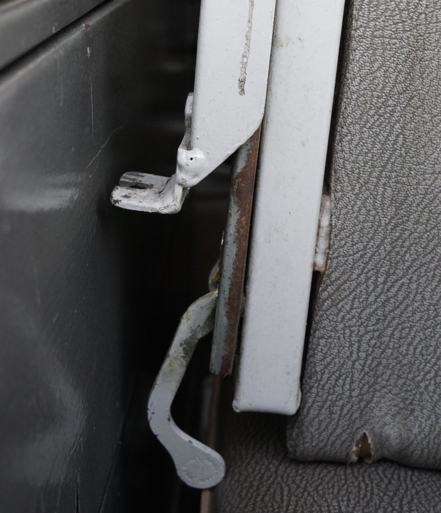

jerryd wrote:it also came with a single front passenger seat. I'll have to take a few pics of the front seat assemblies.
If you take a look at the Dormobile brochure in the Technical & Workshop section, you can see a pic of a S3 with two single front seats. Maybe someone can confirm if a double front seat (and double bed) was still an option ? The current Dormobile Defender does not have the double seat/bed option and places a much bigger cubby box between the front seats.
Your picture of the S2a seat is exactly how my Dormy's looks and I strongly suspect Colin's and Ant's.
Any chance you or Michiel could post a photo of the hinge fittings for the drivers seat ? I already feel another project coming on !

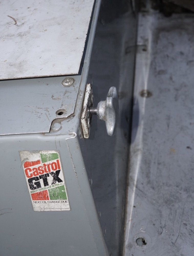

Post by Gromit » Sun Feb 08, 2015 10:18 am
Picture below shows my seat runners.
From the colour of the bracket the runners are bolted through it looks like genuine Dormobile.

Post by Dormy » Sun Feb 08, 2015 3:17 pm
Gromit wrote:Picture below shows my seat runners.
Yep, that's exactly what my Dormy's runners look like (with all the bolts).
