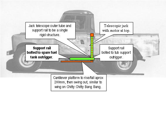

See attached sketch of jus one embryonic idea for a motorised side step.
There seems to be enough room to squeeze a length of box section alongside/behind the passenger seat squab, but failing that, the telecope could go behind the tub bulkhead. ... it could even fit inside the underseat tool box, but lack of headroom would restrict rise and fall, unless it had a double screw action.
It would need a stress job to check the cantilever strength, but in the 1970s I had a cheapo jib crane, (£8) SWL 8cwt (say 400kg), with a 3ft arm. The arm consisted of two lengths of 2" x 1" x 1/8" thick RHS box section. I used it to lift the engine out of an Austin Champ, and replace it with a BMC LD 2.2 diesel. I must have been crazy.
More pondering needed.
602
602
- LRS2 MOTORISED SIDE STEP.jpg (30.43 KiB) Viewed 14484 times

How about a caravan jockey wheel leg ?
http://www.leisure-mart.co.uk/shop/Vpro ... As_88P8HAQ
Replace the wheel with your step and rig up an electric motor to turn the screw. About the cheapest and simplest solution I can think of.

Hi Ian,
I had considered jockey wheels for my POD jacks, but discarded due to limited lift. They briefly crossed my mind for the sides step, instantly discarded for same reason.
But I clicked on your link, and scrolled down past the jockey wheel, to the jockey wheel clamps.
Hmmm! Cobble in a support bar between the outriggers ... use a clamp (or even a clamp above and below the support bar to prevent twisting ... needs thinking through) and there may be enough room in the tool box, and the motor too).
Caravaners are use cordless drills to lower their corner steadies. I was thinking about a motor from an electric bicycle .... probably over-kill.
Thanks for the nudge. Back to the drawing board.
602
