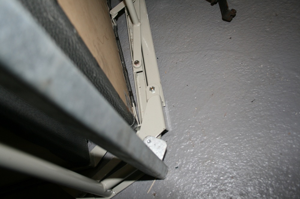

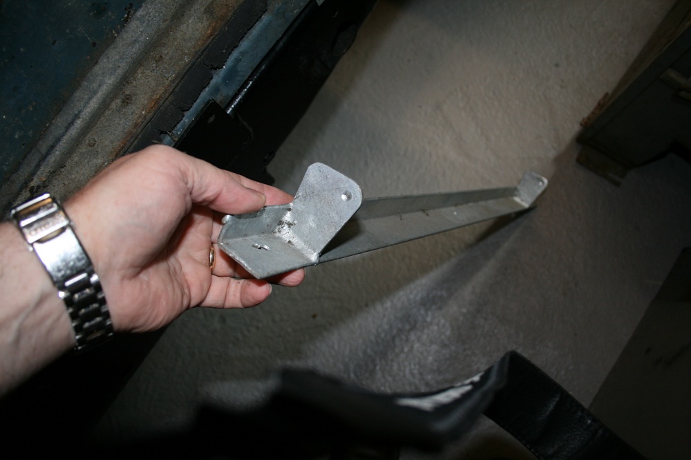

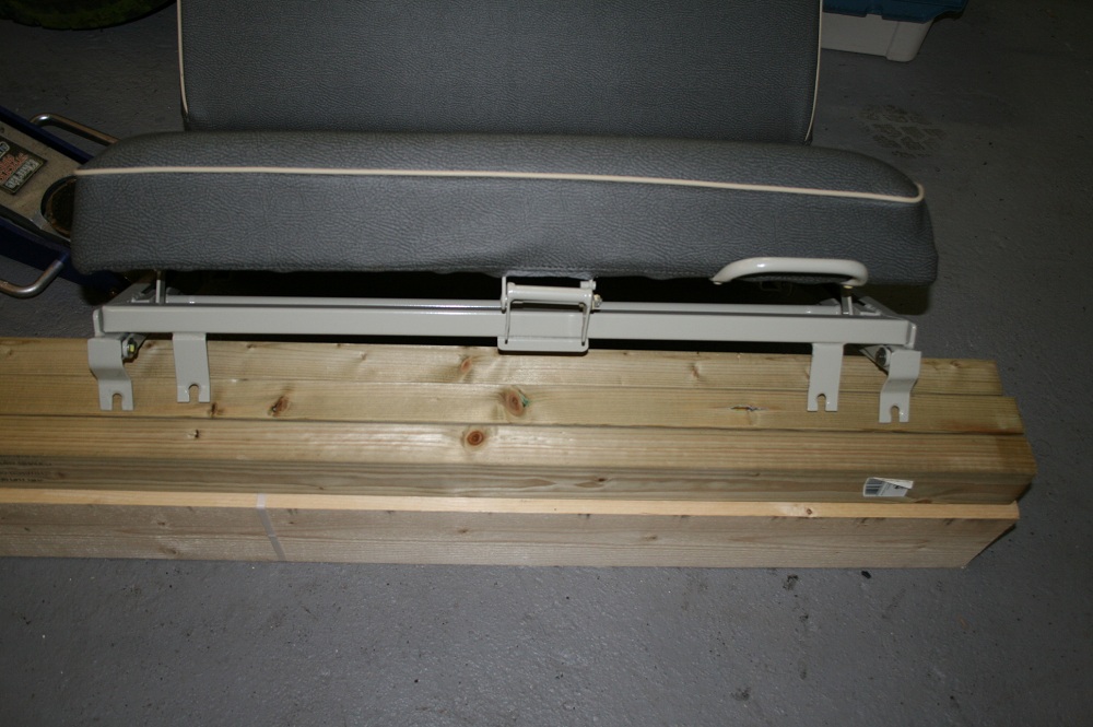

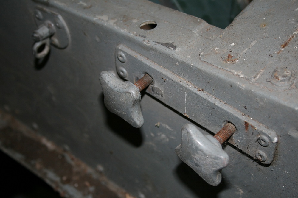

Right, lets see if this makes sense to you.
On the front face of the seat box there should be 4 knurled knobs, these engage with the tangs located on the lower front edge of the dormatic front double seats. The front double seats require slackening of two of the knobs to allow the seat to swivel backwards or horizontal. The swivel function also depends on the mounting rail fixed at the rear of the seat box and which is bolted through 2 holes in the indicated brackets underneath the seat. I have seen mounting rails with two holes, some with one, but can only say that the aftmost and higher hole is the one to use as the frame will foul the seat box when mounted on the lower holes.

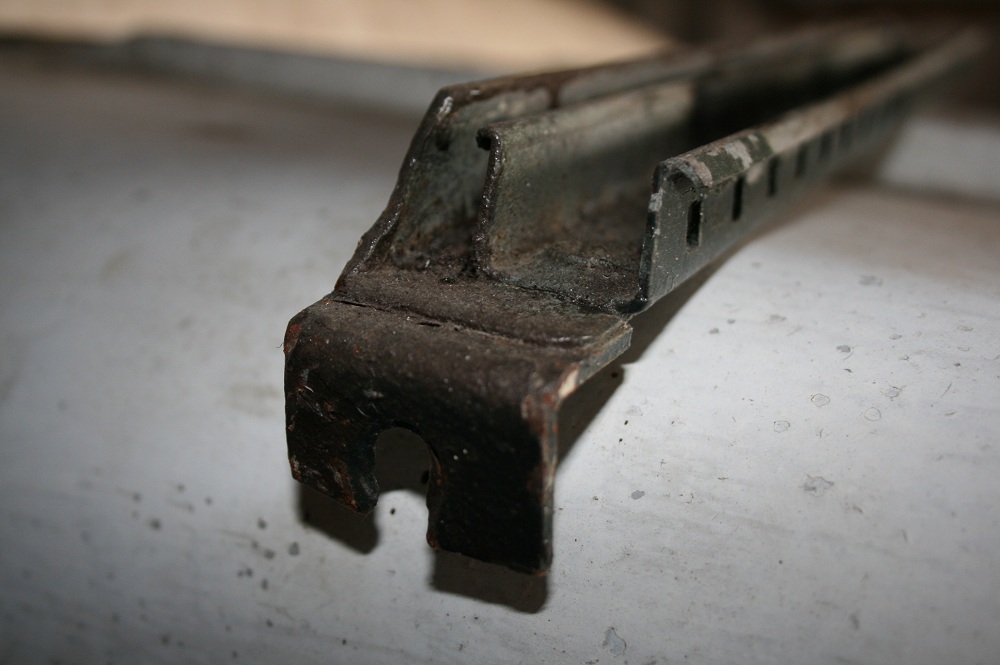

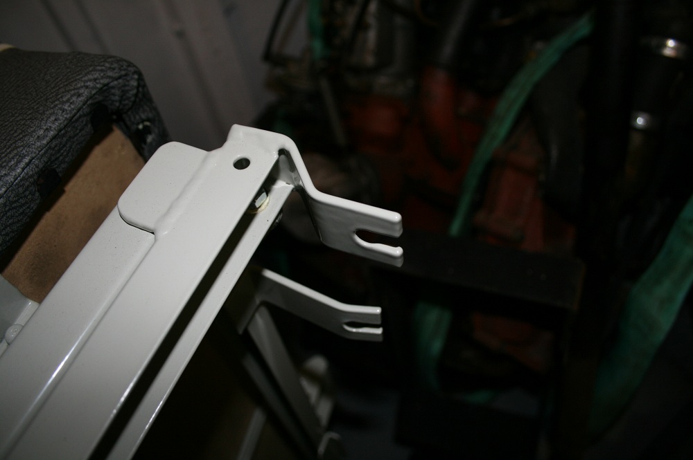

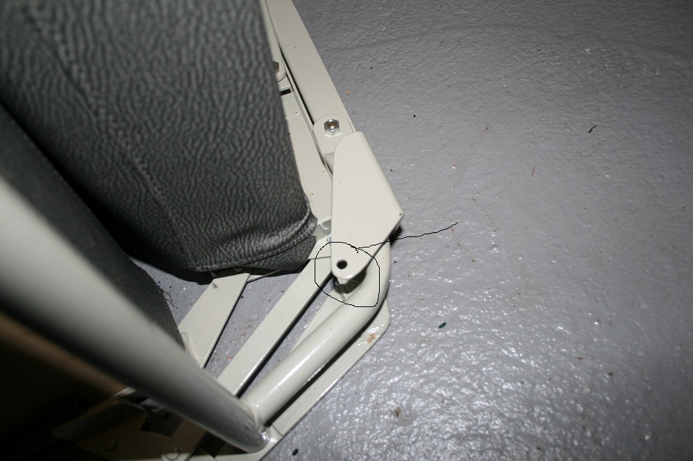

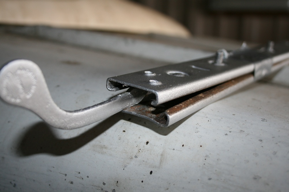

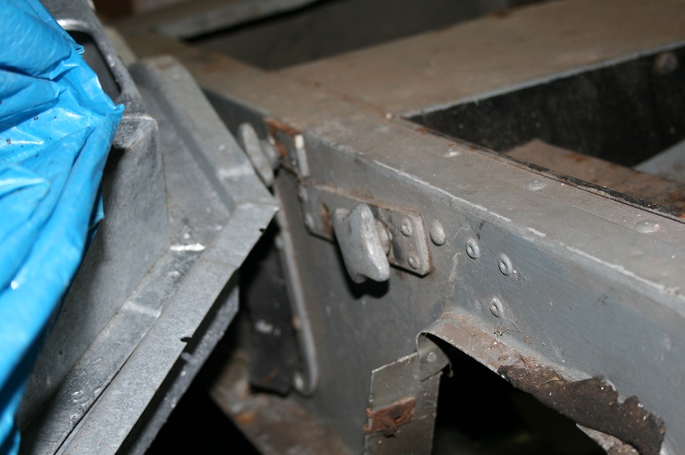

As Alex says, 4 tangs on the front passenger, two for driver seat, but I think with age of your vehicle they would have modified the seat to stop it being tippable for safety reasons so yours may never have had the tanged driver seat.
You will see in the pics below one of the driver seat rails with tang which would allow the seat to tip backwards, the seat can still slide fore and aft, for changing the 6kg gas bottles the tilting option was very easy.
- Driver rail 2.JPG (140.9 KiB) Viewed 26729 times
- Driver rail.JPG (134.62 KiB) Viewed 26729 times
- 4 tang.JPG (185.8 KiB) Viewed 26729 times
