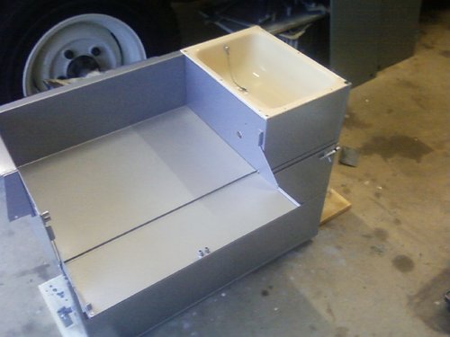

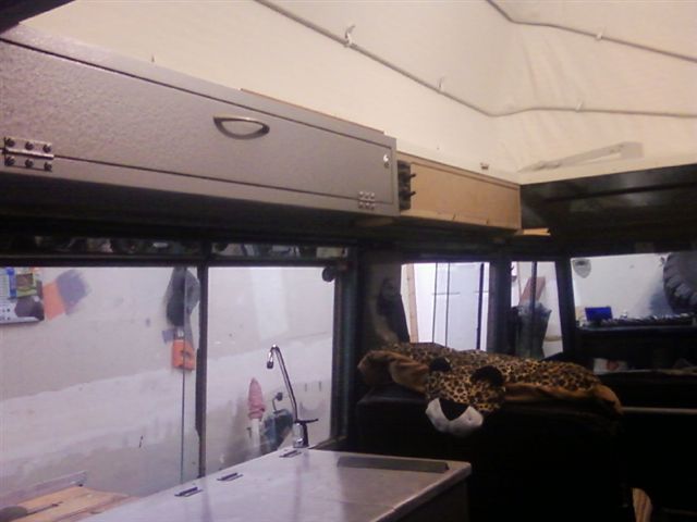

The units were finished in a "hammered finish" but I'm not sure I'd be using hammerite paint. When I refurbished my original sink unit and wanted to paint all the newly made furniture, I purchased the paint from a car paint shop with thinners etc so it could be sprayed on with a proper spraygun. Fortunately there was no major rust on my sink unit but I did have it sandblasted before painting it.
I primed all the bits and gave it three coats of top coat, I did find that the wetter you apply the paint the more hammered effect you achieve, so you need to experiment until you reach a happy medium
I'm really pleased with the results and the finish is hard wearing, nothing has chipped yet and it certainly gets used and abused.

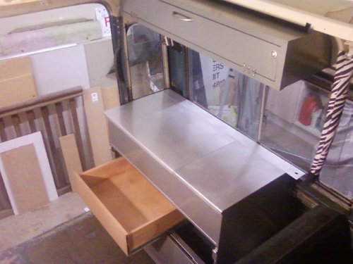

The other useful modification I made was to remake the cooker / sink unit lids in a 3mm aluminium with a rolled front. These can now be stood on without them denting, especially useful when hopping into the bunks.
I also made and fitted a drawer unit to the inside of the cooker unit, it has made all the difference to packing the unit with goodies when camping. It's spring loaded so doesn't move around
A couple of pics of work in progress
- Photo3659.jpg (38.49 KiB) Viewed 11154 times
