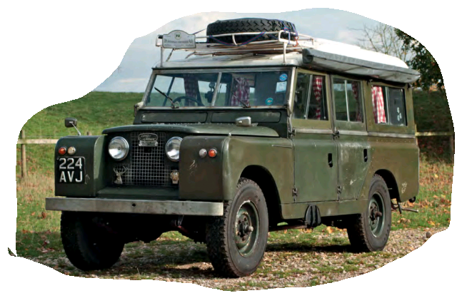

I saw a pictures in the last classic land rover magazine, a dormobile with a side awning on it. Is it someone from here?
Is it possible to have some picture on how it fit and how it's work with the lock system of the dormobile roof?

Yes, it is mine mate. Pm me your details and I will tell you how to mount it. I designed a bracket that involves no drilling and is easy to fabricate. Dan

I fitted the front section of my awning to the roof rack and then made a stepped bracket which is fitted externally just behind the kitchen window. I put a metal plate on the inside of the vehicle and then bolted the bracket to the aluminium / plate, this gives a secure fitting. Make sure when fitting your awning to keep it parallel with the pop top roof and equal distance from the gutter :tiphat:
Mine is fitted probably 150mm higher than Dan's.

Loic, send me your rmail address and I will give you details. My bracket design can be higher if needs be as it utilises the gutter (no drilling of vehicle) and has proven very robust.
